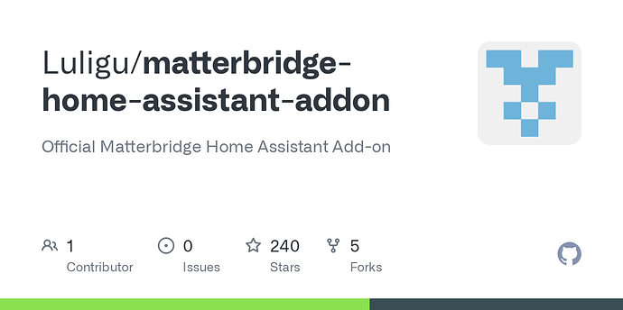

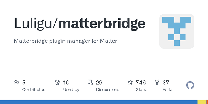

I don’t think this is the Matterbridge you’re referring to.
Because this started as a stand-alone replacement for Homebridge, it’s not as straightforward to integrate, IMO.
Thank you, mixed links indeed - edited my comment.
It took me about 15mn to have it up an running. Install in a docker, and add the HAOS plugin and use a token.

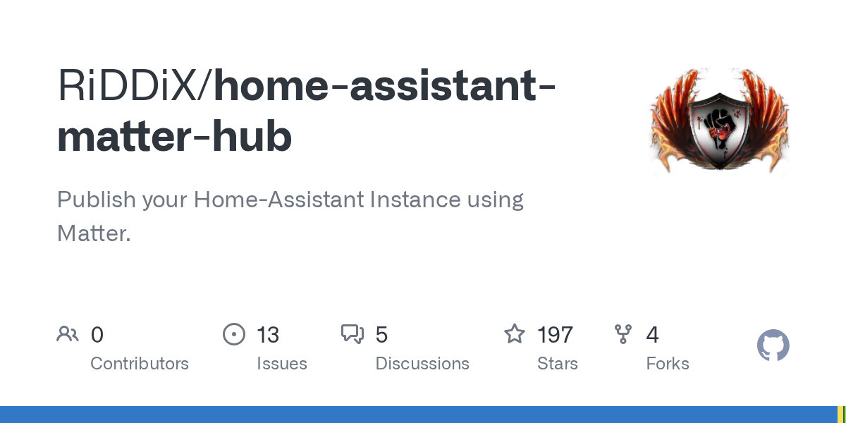

This fork seems to have a lot of activity and already released a bunch of new features and fixes, I just migrated to it (very easy instructions to follow), I recommend it:
Thanks for this. I made the switch and it’s working great. I had a problem with the migration instructions, so AI helped me figure it out (it had to do with where the back-up files were placed so the new add-on could find them.)
Working great for me. Did the migration from my t0bst4r hub. Under homeassistant/addons_config there was a folder which ended *_hamh. I copied the content of that folder on a separate location. Then uninstalled the t0bst4r addon (without removing the data!). Installed the RiDDiX addon. I first had to start it to show a new _hamh folder under homeassistant/addons_config. I then copied the old content of the old t0bst4r _hamh folder to the newly created _hamh folder and restarted everything.
I just switched to the fork as well. Many thanks to @t0bst4r for the work and many thanks to @RiDDiX for the fork!
Same, it was very easy to switch over with the clear migration instructions.
