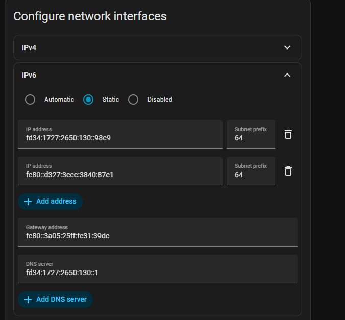

I feel like I’m missing some HA setting that is preventing it from being able to use IPv6 even though it’s responding to it, but I do not know where to look.
This is the HA setup for network:
All of those addresses can be pinged from my PC (same VLAN as device and same as HA). I have rebooted several times just in case (also the device).
