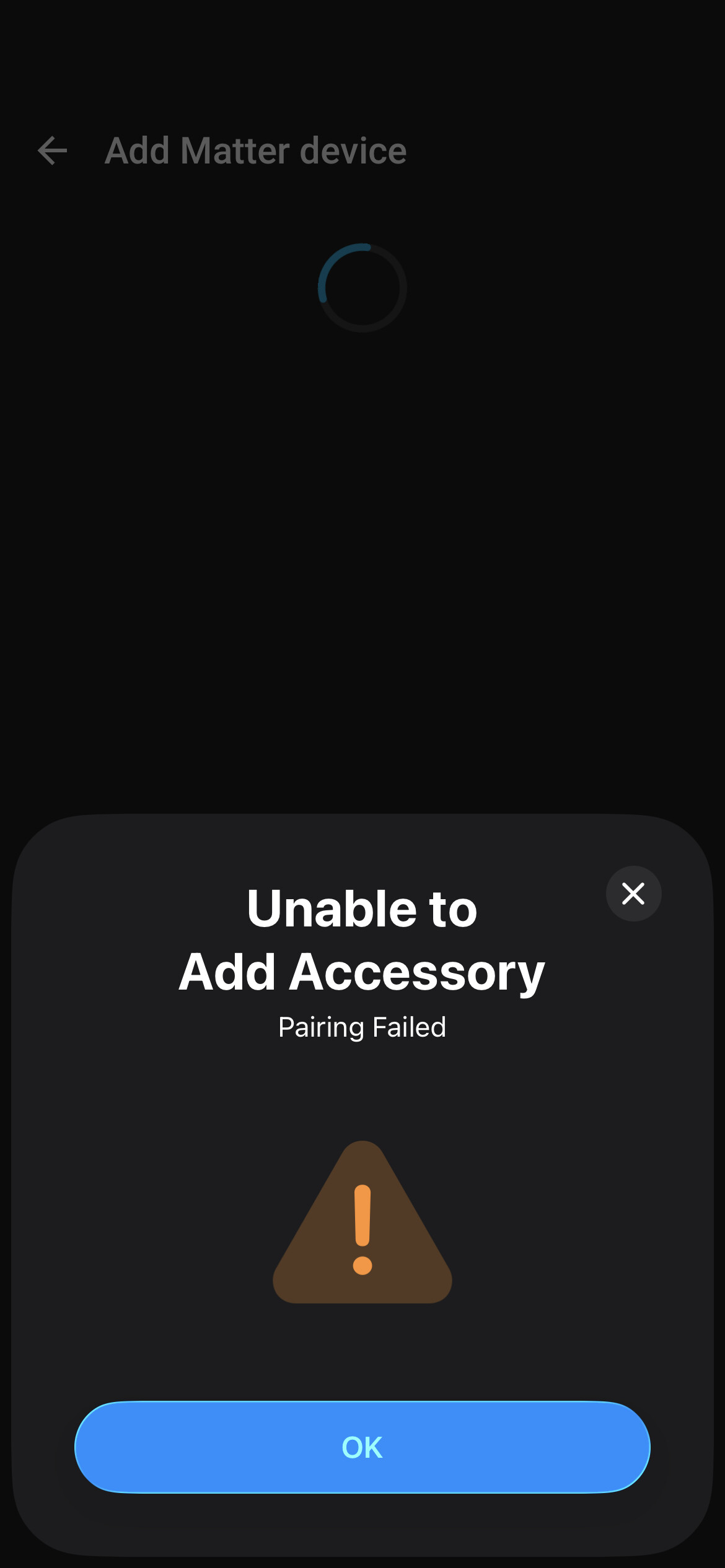

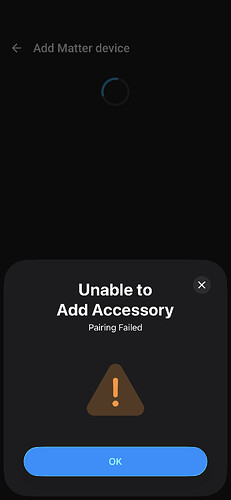

Here’s what happens when I attempt to add a device via QR code using the companion app:
Every single time, that’s all I get regardless of the device that is attempting to be commissioned. The app goes through both the ‘Contacting’ and ‘Setting Up’ phases, then errors out with this exact message. The logs have literally nothing in them - even when set to debug level - that indicates what the problem might be.
For reference, that screenshot was taken after again attempting to commission a freshly factory-reset Ikea Kajplats light bulb, model no. 106.114.96 with an E12 base. There are three other devices that have produced similar results: a pair of Ikea Timmerflotte temperature / humidity sensors (model no. 506.189.57) and an LG 65UT80 TV. I realise that the Timmerflotte sensors are known to be touchy, and having the TV added to Matter is a near-zero-priority consideration so have only used it as a test device with no intention of putting it into production in the future. The light bulb definitely needs to be functional in HA, though, because one of the roles it’s intended to fulfill is establishing the Matter RF mesh outside of the server closet - and the Timmerflottes will eventually need to route through it once it’s working. FWIW, placing the light bulb into Zigbee mode causes it to join the Zigbee mesh without issue and be controllable as expected via HA, so it is believed to be functional.
