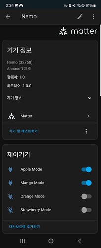

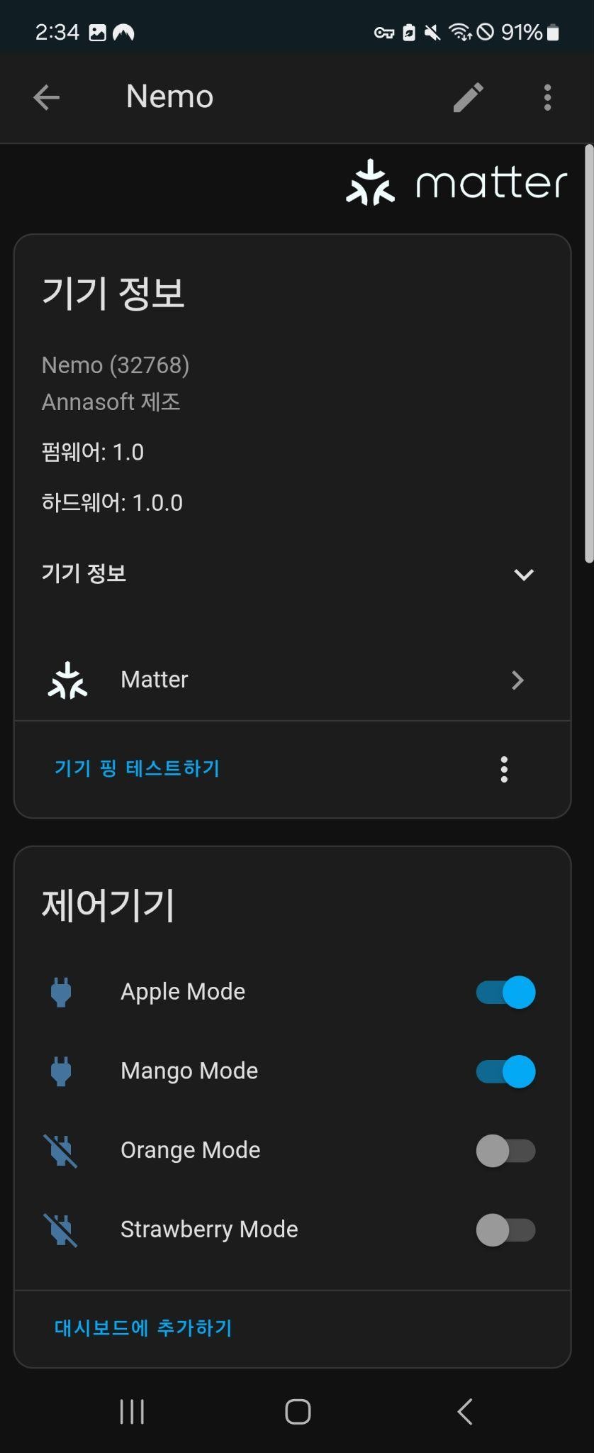

The attached images show how our device is currently displayed across different platforms. This is not a Home Assistant-specific issue — the same result appears across all platforms.
The closest example of what we are looking for is actually a screenshot captured from Home Assistant in July last year, when HA was displaying the UserLabel value directly in the UI. That is the behavior we would like to see.
