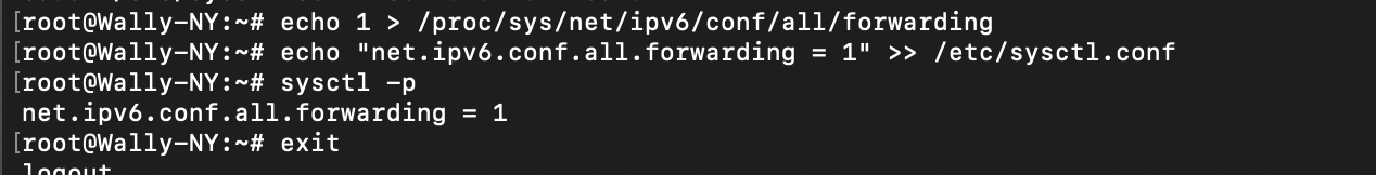

The fix:
sudo sh -c 'echo 1 > /proc/sys/net/ipv6/conf/all/forwarding'
To make it permanent add to /etc/sysctl.conf:
net.ipv6.conf.all.forwarding = 1
Then sudo sysctl -p
After enabling forwarding, commissioning worked immediately through the HA companion app.
Docker OTBR can’t enable this itself even with network_mode: host since it runs in a container. This needs to be configured at the host OS level.
