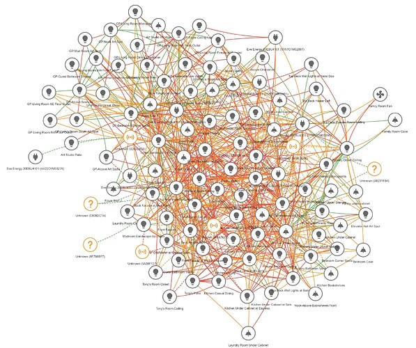

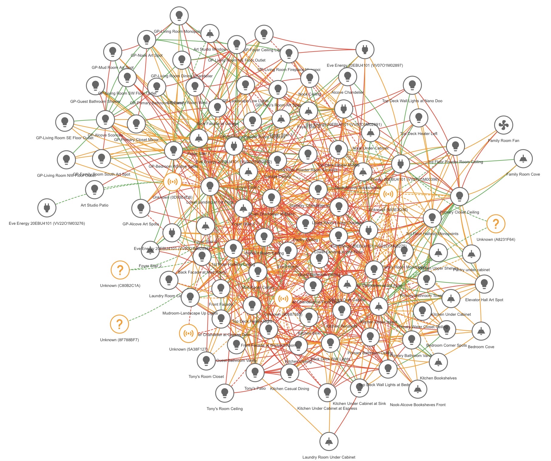

Shall we take a look at your Thread mesh? Open the Matter Server web interface, top-right you have a new view Nodes|Thread|Wifi. Post the Thread picture please.
The interesting thing is to know if you have one or more Thread border routers in your mesh. If there is more than one, check if the failing devices are all bound to the same one.
Ok, attached is my Thread mesh. Not sure how helpful this image will be. I’m not sure mesh quality is the issue. Between my matter “storms” things are very stable. However, every six hours something disturbs the mesh somehow and the weakest devices farthest from the Apple TBRs pop offline and then come back. I’m actually a bit surprised that I have any distant areas because I have devices evenly spaced throughout the house.

The mesh shows three routers. Two are really central, one is at the “periphery” only.

Four routers. Two of them (HomePods) are in an outbuilding and handle just a few devices. It far enough out to be a bit unstable out there without them.
