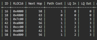

With the ZBT-2 I can go into the terminal and see with “Router Table” command that when they are working the link quality is pretty good (mostly 3’s with some 2’s)
Ignore the top two rows. One of them is the a nest I keep on my in-laws side so they can use the internet and the second is the ZBT-2 itself which I’m assuming the LQ of 0 is normal.
However, when the entire downstairs portion drops off the network the ZBT-2 (also downstairs) is not connected to any routers.
