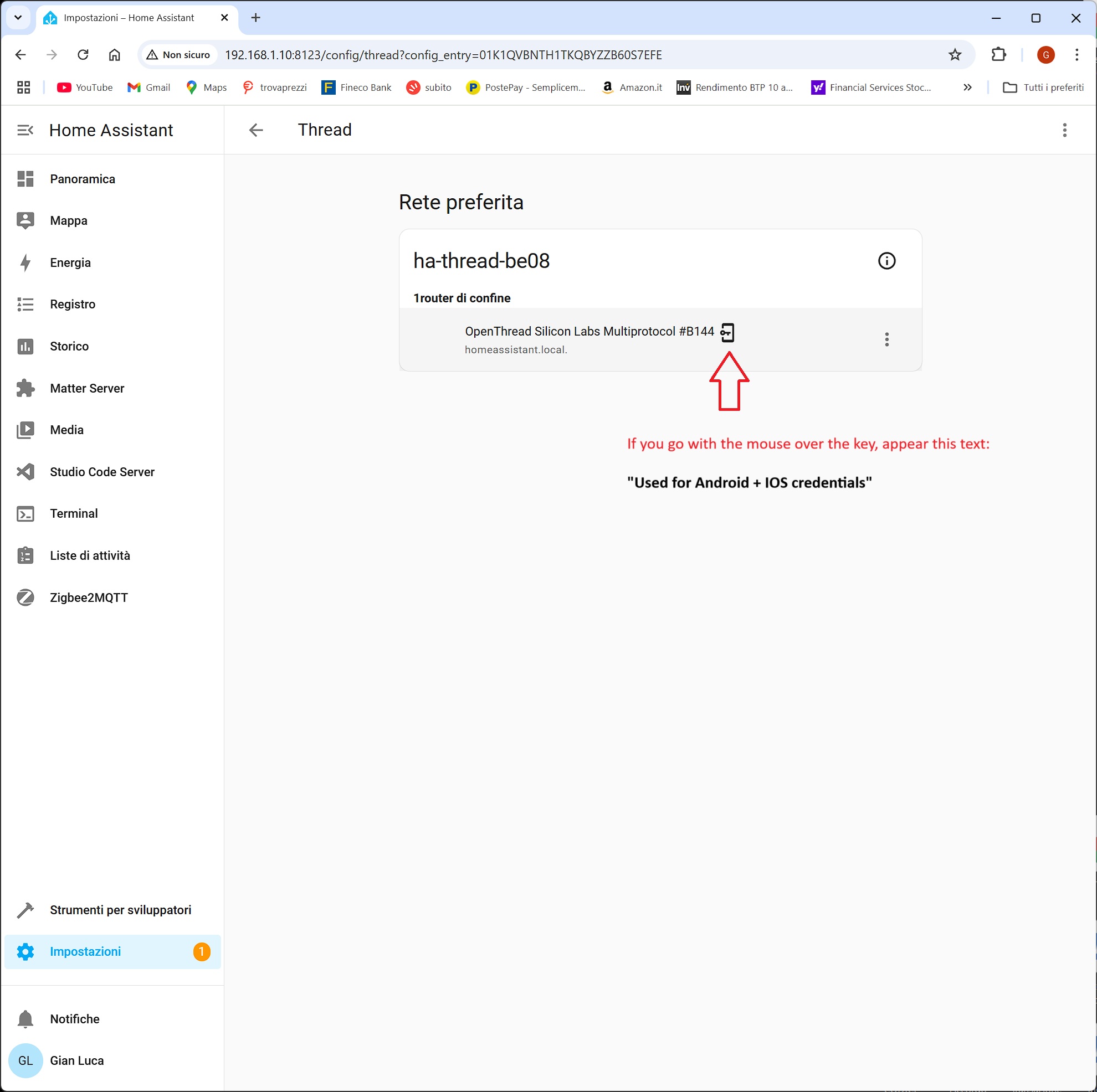

If you go to → Settings - Devices and Services → Thread → Click on the gear → and go with the mouse under the Key
Appear a text: “Used for Android and IOS Credential”

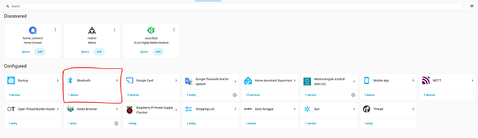

When I install from the hassio repo, it is not visible in the “devices and integration page”
Here the one suggested is the official HA Matter Server. However i think its a mess if I add this one also, as then there will be 2 concurrent Matter Servers running.

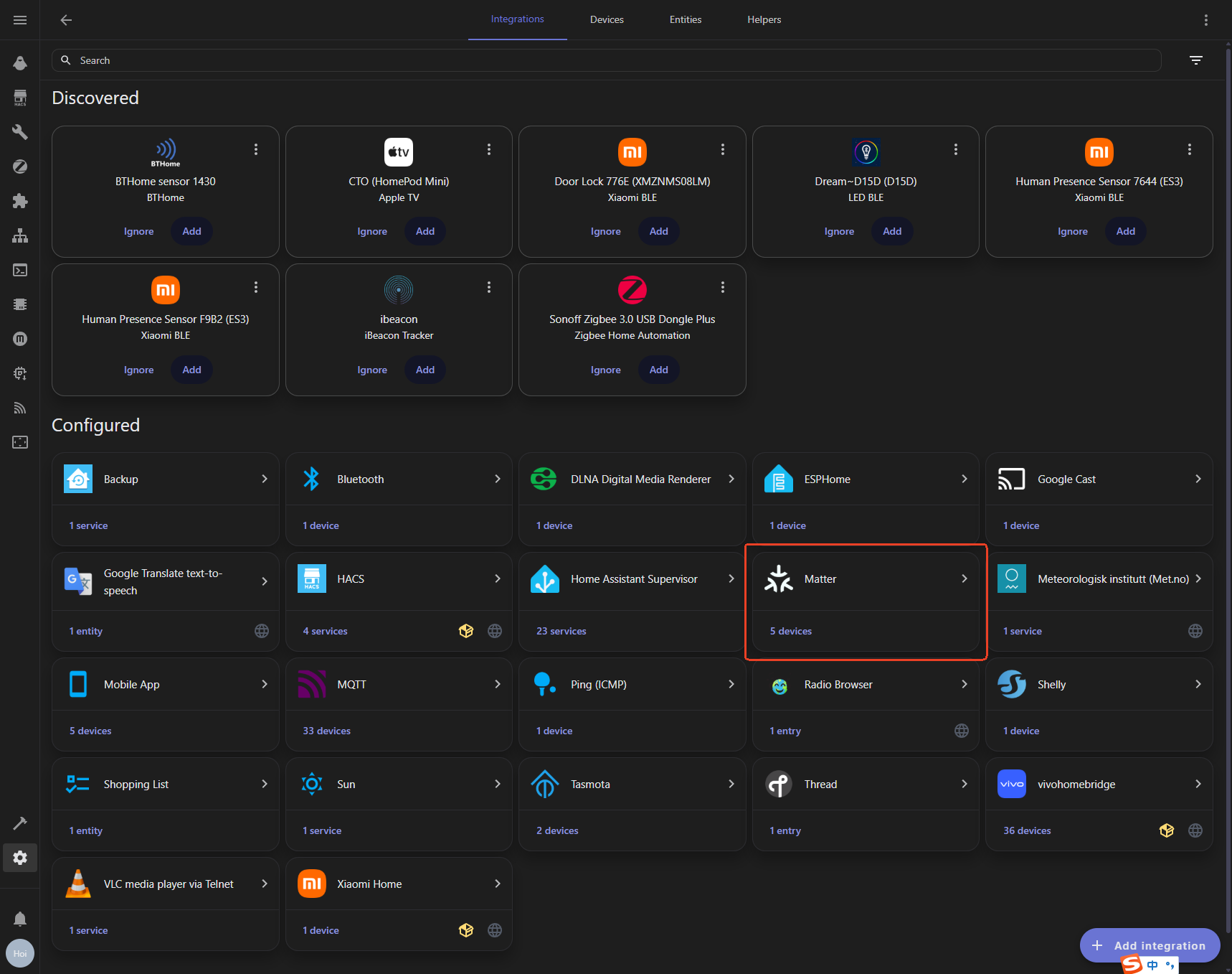

I was able to pair an IKEA Matter device in both hassio repo (8.1.1). And the official repo (8.1.2). However I believe there was some errors in log for 8.1.2 i didnt see for 8.1.1,
Also I believe the device was only visible under “devices” when added in 8.1.2.

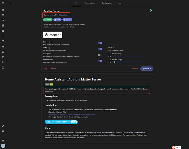

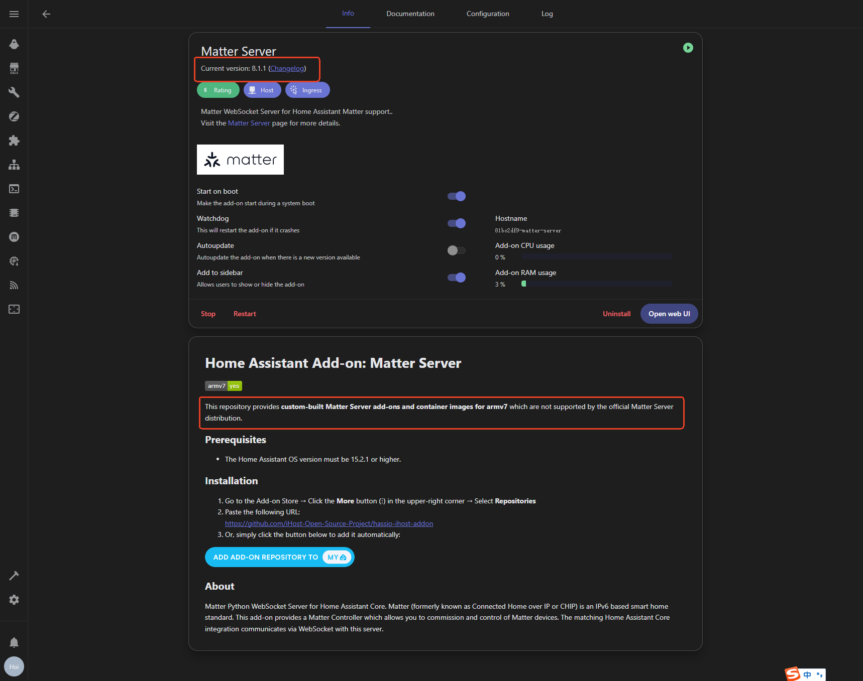

Have you installed Matter server 8.1.1 from the hassio repo, or the official 8.1.2 from the HA repo?
I am using Matter Server 8.1.1 from iHost Open Source Project (the hassio repo). Never used the official 8.1.2 because it doesn’t support armv7 (32 bit) architecture.
Do you know is there is some specific sonoff code in the hassio repo?
There are some custom codes but they are mainly for compatibility with armv7.

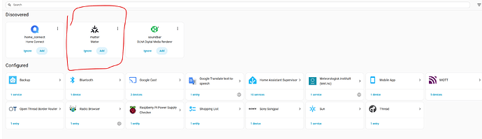

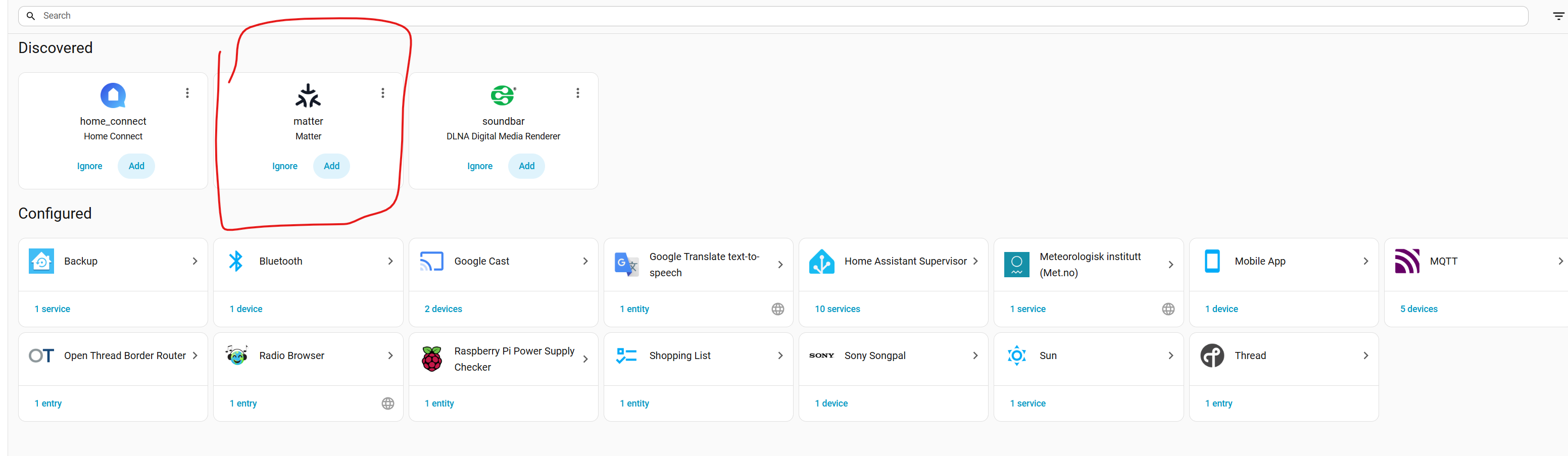

You mean it was not automatically discovered, right? You can always add integration manually. There is a button called Add integration at the bottom right corner of Devices & services -> Integrations page.

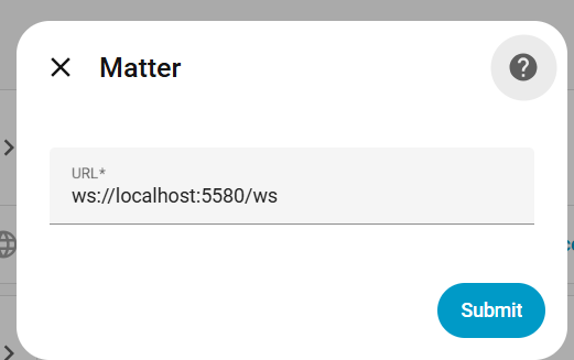

I am actually not aware how you were able to add the hassio repo Matter Server in the configured pages as you show yourself. Mine wouldn’t appear, only the official integration. And if wanted to add integration of the hassio one, it wanted me to point to an IP adress which I dont know anything about, and what to insert here.
If anyone else is finding this thread, I am running the HA OS on x86/x64 linux distro. I installed the “offical” HA Matter Server integration 8.1.2, and I have been able to add my first Matter Device to my HA system. The IKEA MYGGSPRAY motion sensor.
So now I have successfully added old IKEA bulbs on Zigbee, and new Matter device on single radio.
This is all on 1 single radio, the Sonoff ZBDongle-E with official 4.6.0 Multi-PAN firmware.
Really happy I didn’t need to spend another 25Euro on new radio, but could use the same for both protocols.
Even through I wasted alot of time getting this to work, this thread pointed me in right direction. The official Sonoff page from june-2025 had some missing holes in the explanations.
