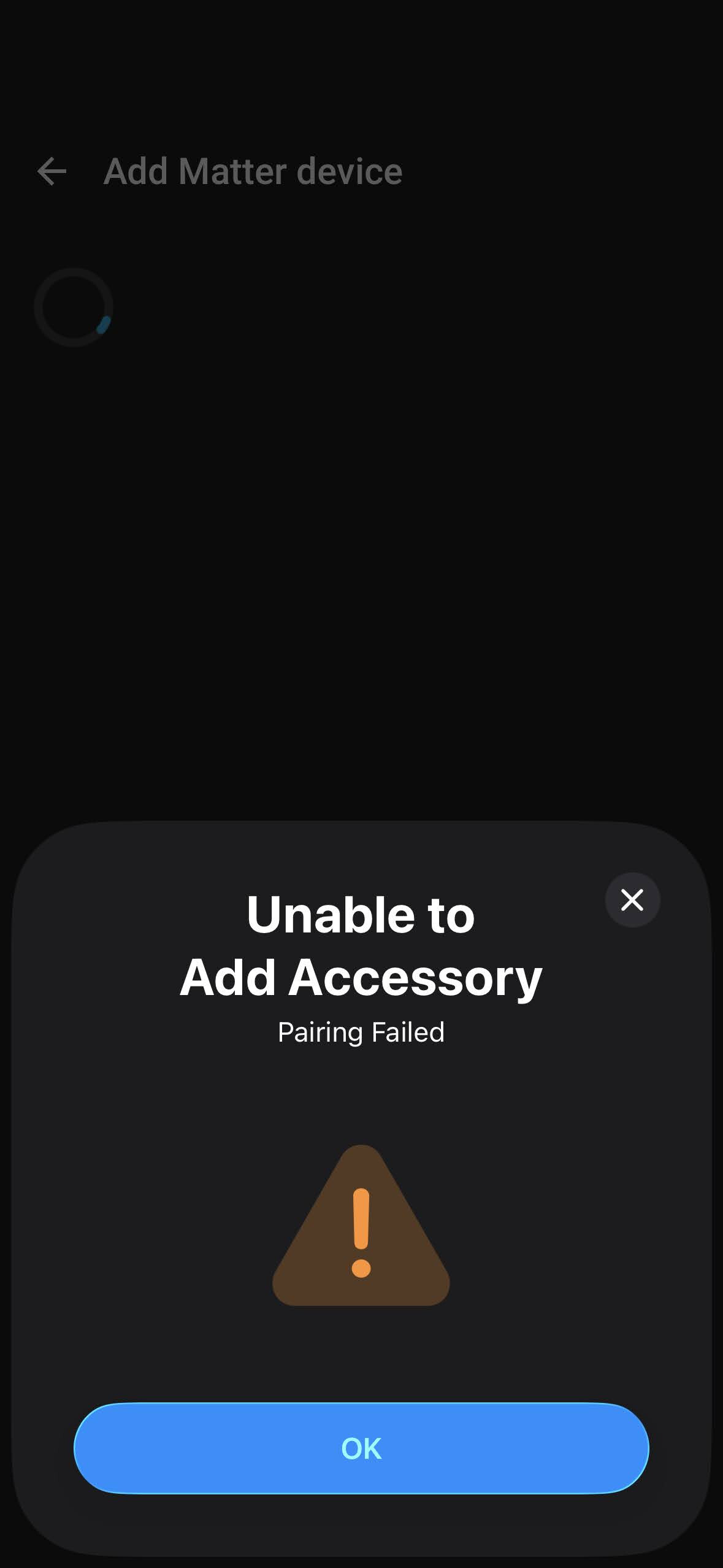

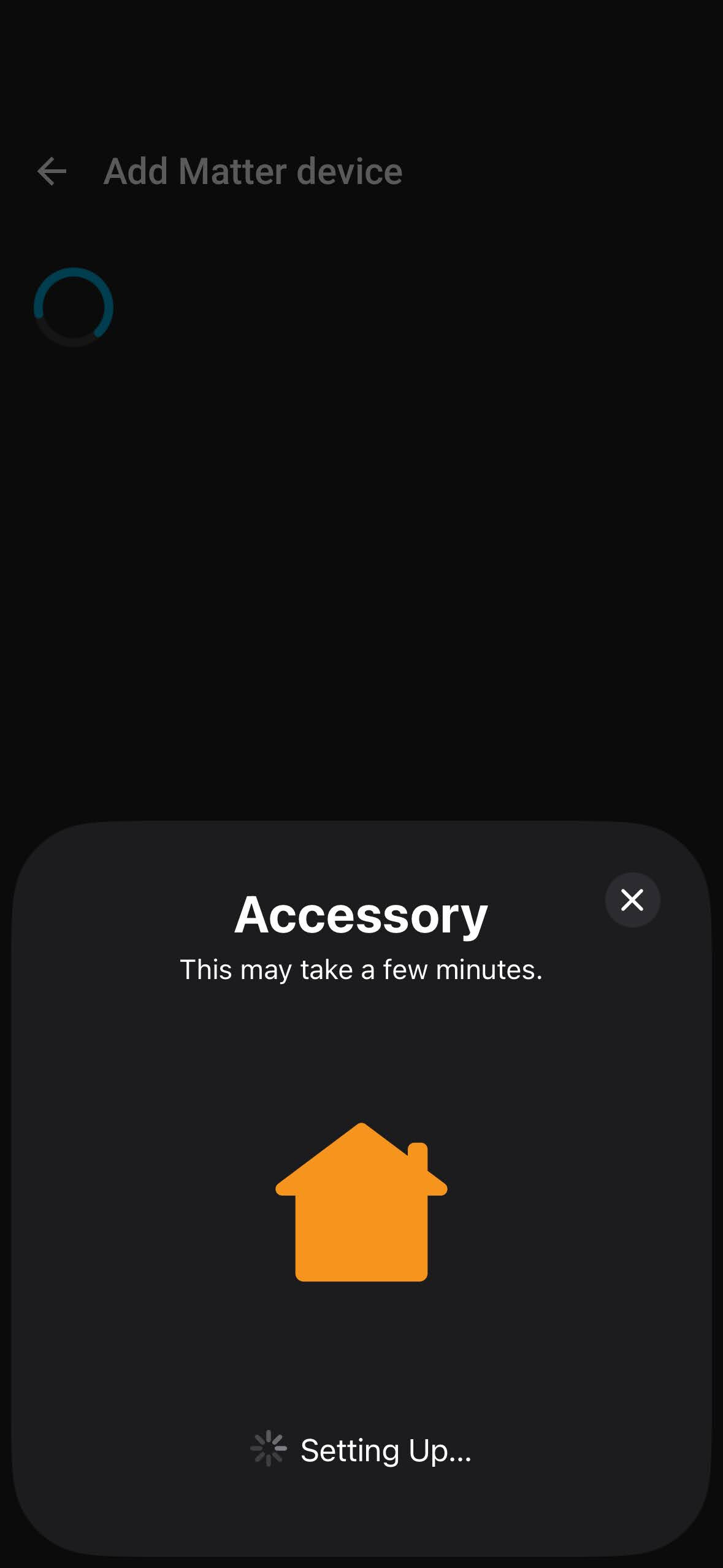

Hey. I can't connect my Nuki Lock 4Gen Pro with my homeassistant Matter. I connected my Nuki Lock 5gen Pro via matter just fine: activated Matter inside the lock, then it says "Add it in your home automation app", I go to Matter -> Add Device in HA, I add the code that is at the back of the lock (because I don't have the box it came with where the QR code is), and then HA commissioning process says "Home assistant" wants to add the device to "Home assistant", I click that button, and then it shows "Unable to add accessory Pairing failed"... Any tips what I might be doing wrong?
Usually network configuration issues, particularly with IPv6, preventing the one-off remote vendor connection for onboarding to occur.
What do the error and debug logs say? [please format them with </> for forum readability if you are posting them]
OK, sorry, it seems it was just the battery, 24% apparently wasn't enough (despite the lock working fine otherwise). I recharged that and it works just fine now.
