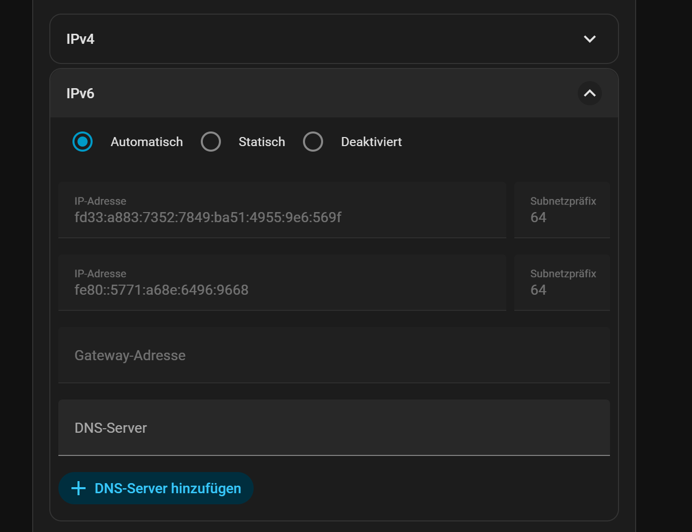

Also, I don’t really understand the IPv6 part. I’m not using IPv6 in my home network — I think my router (FritzBox) doesn’t even support it via DHCP. But here’s a screenshot of how my IPv6 settings look in HA!?

One of the features of IPv6 is that, when it’s enabled on a device, it will always assign itself a working “link local address” (LLA), allowing it to communicate with all other IPv6-enabled devices on the LAN. Even if the router has IPv6 disabled, devices will be able to talk to each other, they just can’t send traffic further than the local broadcast domain. So you do have IPv6, but your router is not participating.
Matter was designed to work with these LLAs so that people don’t get tripped up having to configure anything for IPv6.
So IPv6 won t work for me? Do i get it right?
