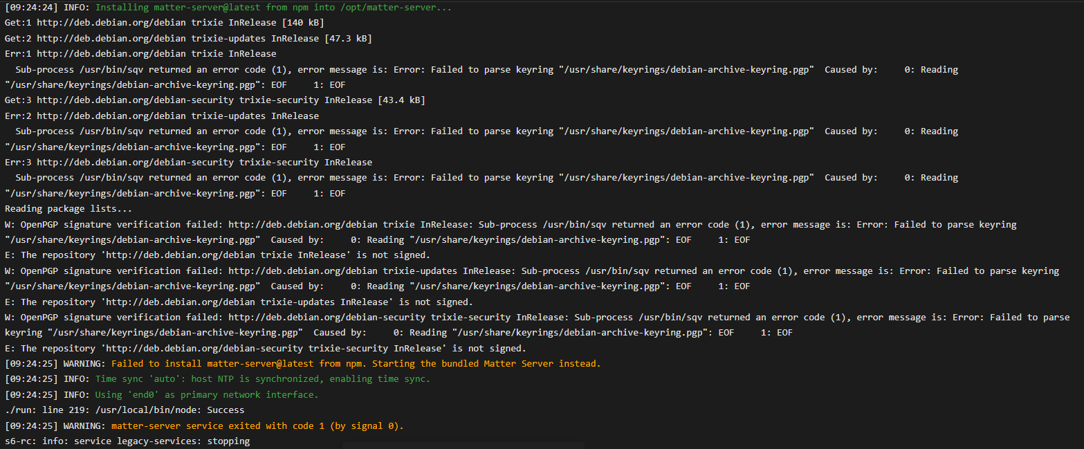

• Beta mode (fails to install from npm due to broken Debian keyring, then falls back to the same crash)

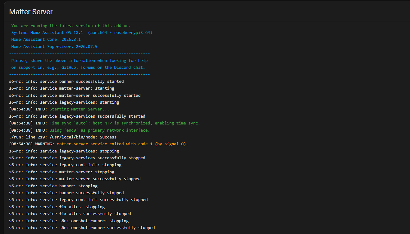

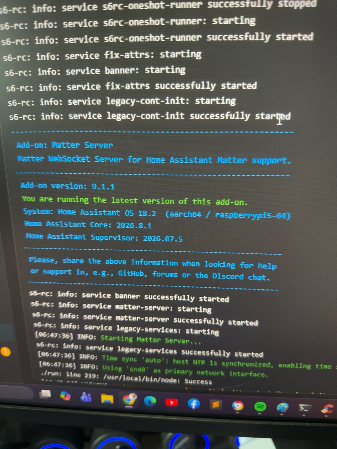

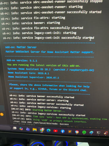

Log (consistent every time):
[xx:xx:xx] INFO: Starting Matter Server…
[xx:xx:xx] INFO: Time sync ‘auto’: host NTP is synchronized, enabling time sync.
[xx:xx:xx] INFO: Using ‘end0’ as primary network interface.
./run: line 219: /usr/local/bin/node: Success
[xx:xx:xx] WARNING: matter-server service exited with code 1 (by signal 0).

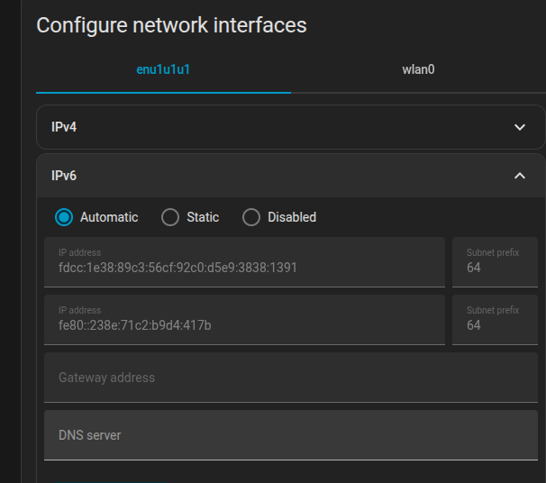

How about IPV6, have you enable it in HA (enable it on the nic)?
