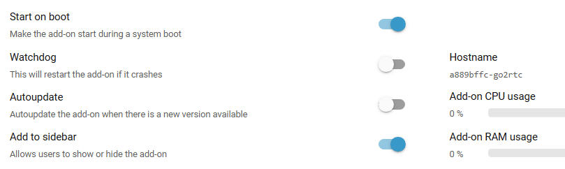

This is exactly what a classic memory leak looks like.
Watch the RAM usage in the add-on, and I’ll bet you see it go up over 6 hours.
Turn off the watchdog and if I am right, the add-on will stop in about six hours and not restart.

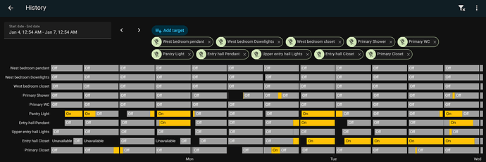

I’m seeing this too. All my matter devices connected to my OTBR go offline every 6 hours too. The system is an HA Yellow.
And it’s way more precise than a memory leak. It’s goes down precisely every 6 hours.
Though sometimes recovery onto the network takes extra time for some devices.
I checked and I don’t even have the watchdog turned on and the memory is barely in use. With CPU addon usage at 1.3% and Memory at 0.1%
My system has about 90 nodes and the behavior is specific to the 75 or so nodes that are on the HA Yellow Open Border Router.
I have ~15 nodes on a HomePod in a detached structure which is outside of radio range and they don’t go offline with this cadence. And as I’ve read about different thread routers colliding I tried unplugging the homepod for a night taking it and all the devices connected to it offline and there were still outages on schedule while OTBR was the only active thread network.
