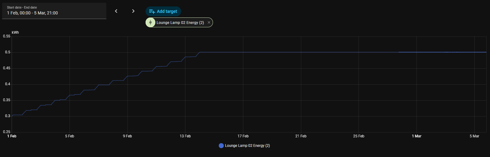

Some of mine stopped reporting properly with the same value present. I looked and the Energy and Power sensors had duplicated on 7 out of 8 plugs in HA.
The original sensors previously known as Energy is now Energy (2) but the new data is coming in one Energy (1), requiring updates to all the dashboards and graphs.

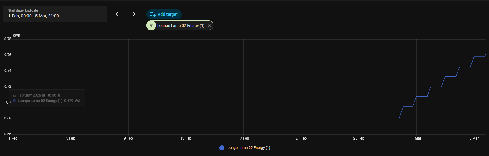

I have 4 P110M plugs that all stopped reporting energy usage around 14th Feb. I’m new to HA and home automation in general. How do I check if they have internet access, and how do I re-interview them?
Actually looking more closely at the device information there looks to be 2 energy sensors(?): Energy (1) and Energy(2).
Energy (1) started recording around 28h Feb
Energy (2) stopped recording around 14th Feb
