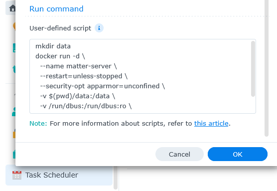

Did found this:
mkdir data
docker run -d
--name matter-server
--restart=unless-stopped
--security-opt apparmor=unconfined
-v $(pwd)/data:/data
-v /run/dbus:/run/dbus:ro
--network=host
Made a "Task Scheduler"
Ran it and now I came further, now I can scan the QR-code from the device.
BUT
got a new error message:
Tread‑limit router needed.
Whats now?
