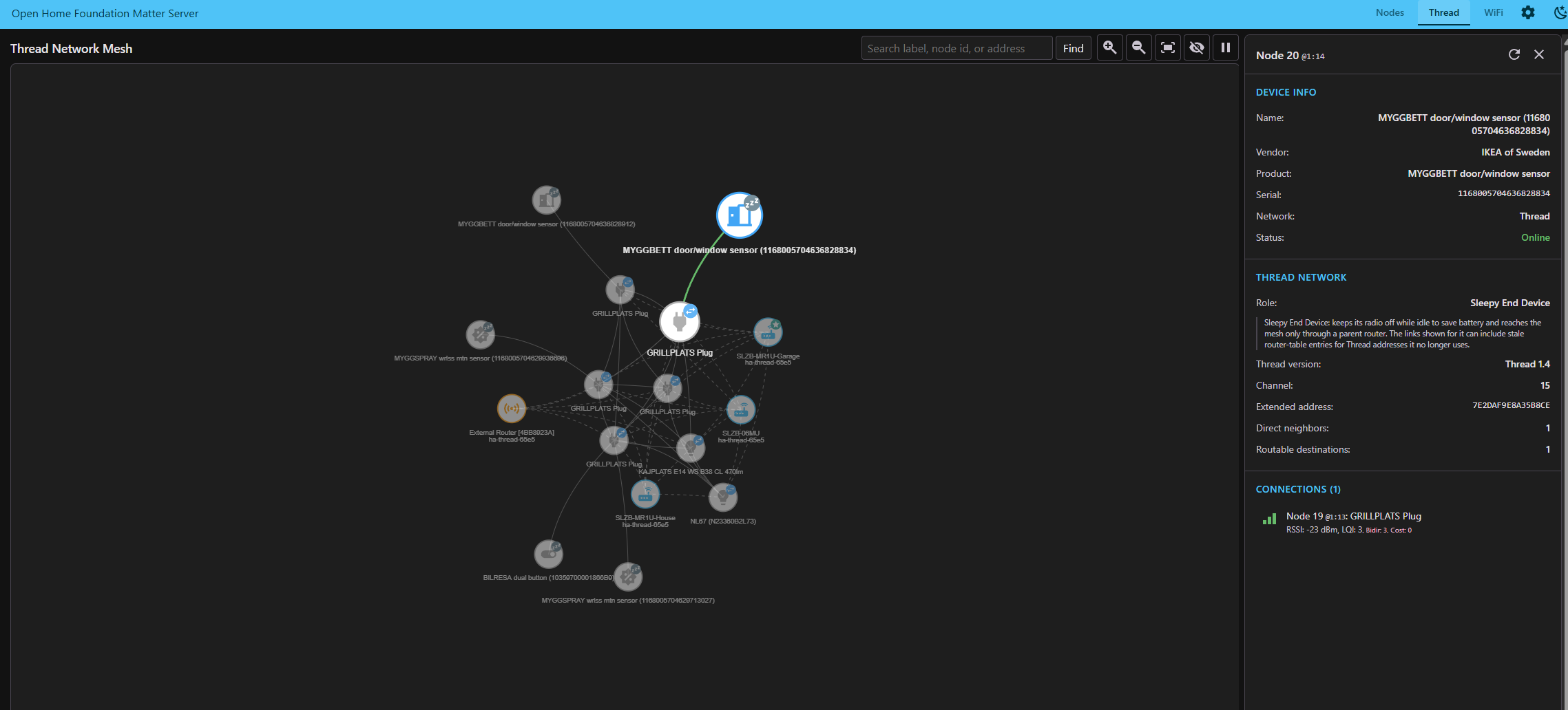

Look at the below:
If for example one of the MYGGBETT devices drops off, for whatever reason. I know its a window/door sensor but where is it. There is no association to an HA device name.
Or am I missing something either obvious or non-obvious. Its the one issue thats preventing me from going all in on Matter/Thread. The Wifi Map has the same issue
[Yes I have three border routers, in three different locations in the house, and that seems to work quite nicely.]
As an Update - I can manually edit the node name - which I guess is a workaround. Its a shame its manual and not automatic as I still have to work out what is what
Manual modification of the device node name right after initial installation seems the only way to do this.
I guess that doesn’t help much if you already installed a bunch without doing it. :slight_smile:
Yeah - thats my immediate problem. Which GrillPlatts (for example) is which without breaking each one, one at a time.
