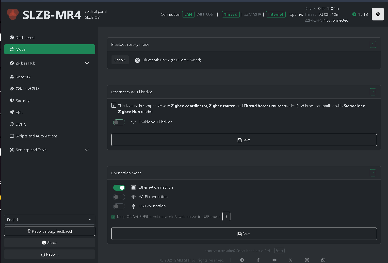

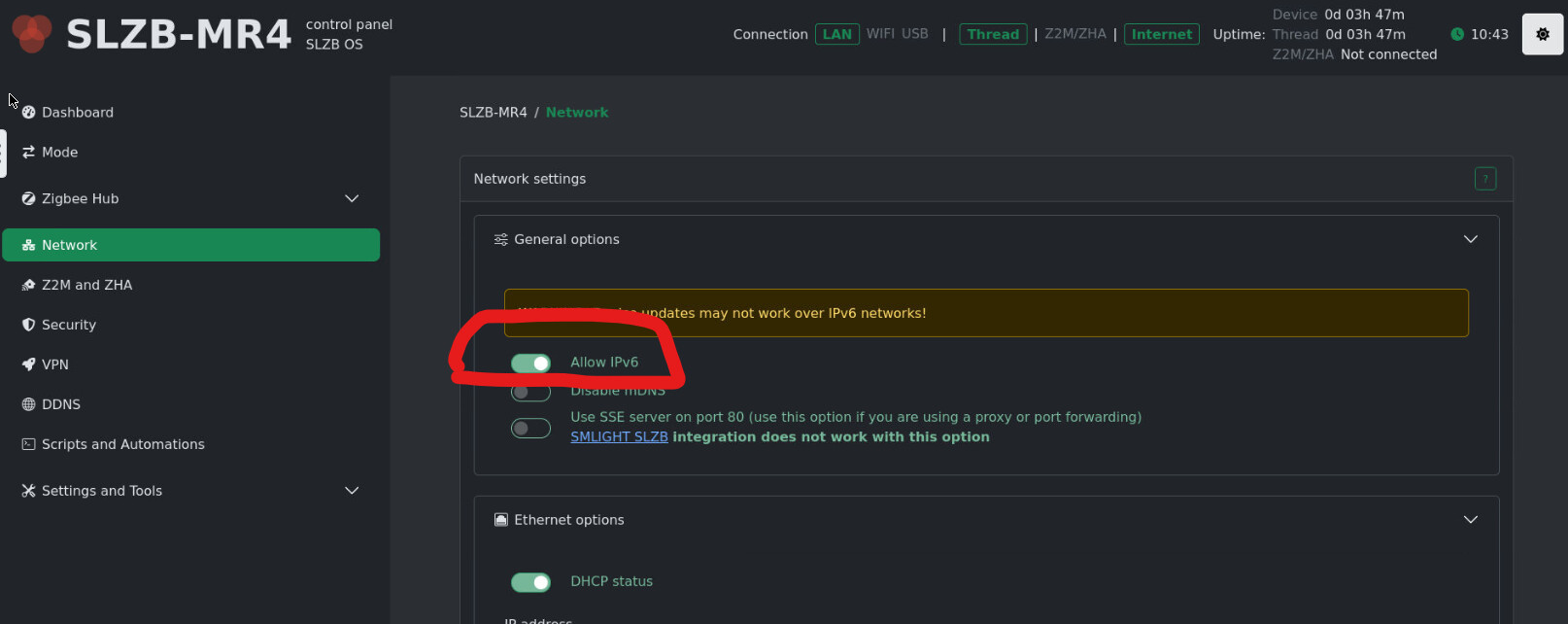

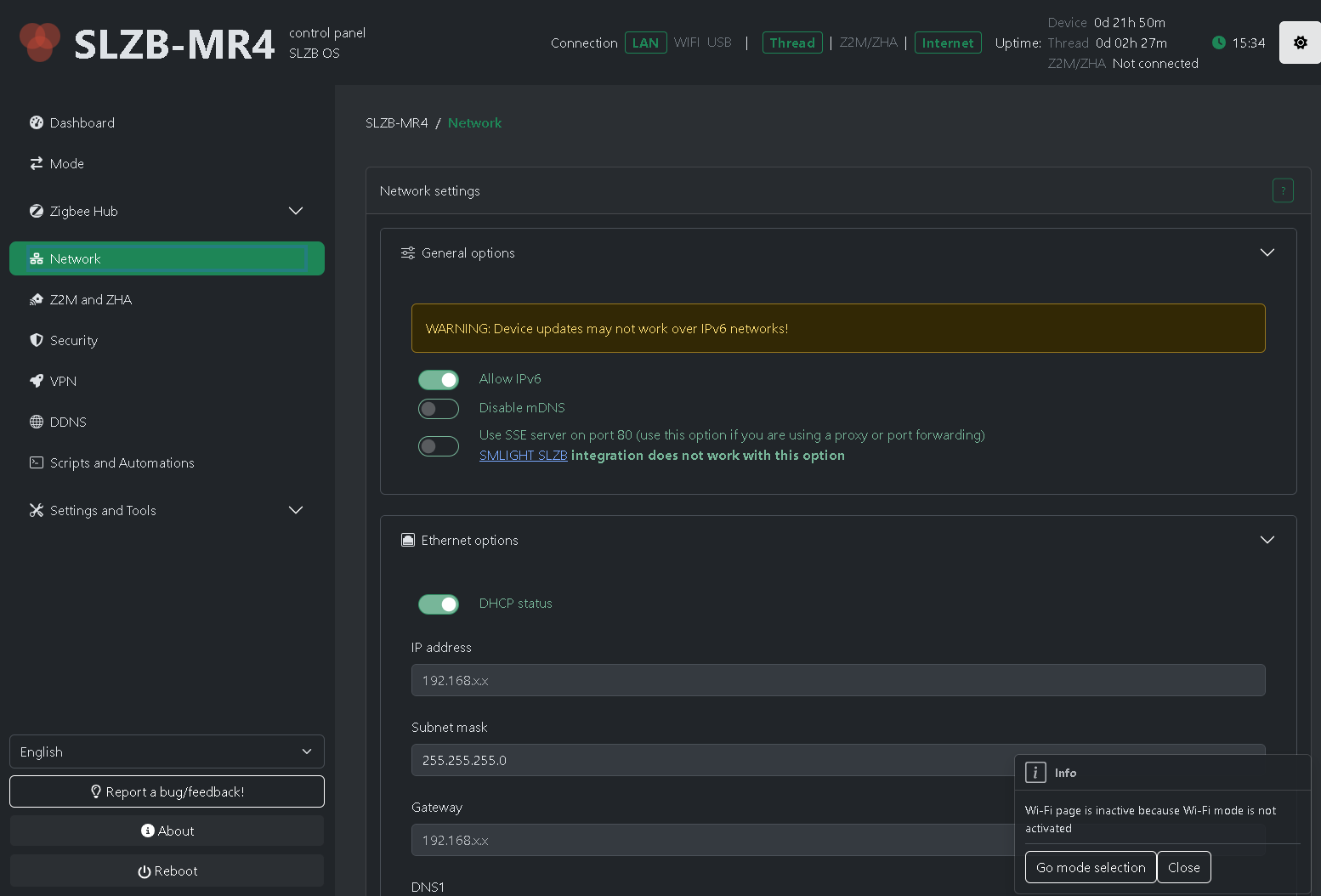

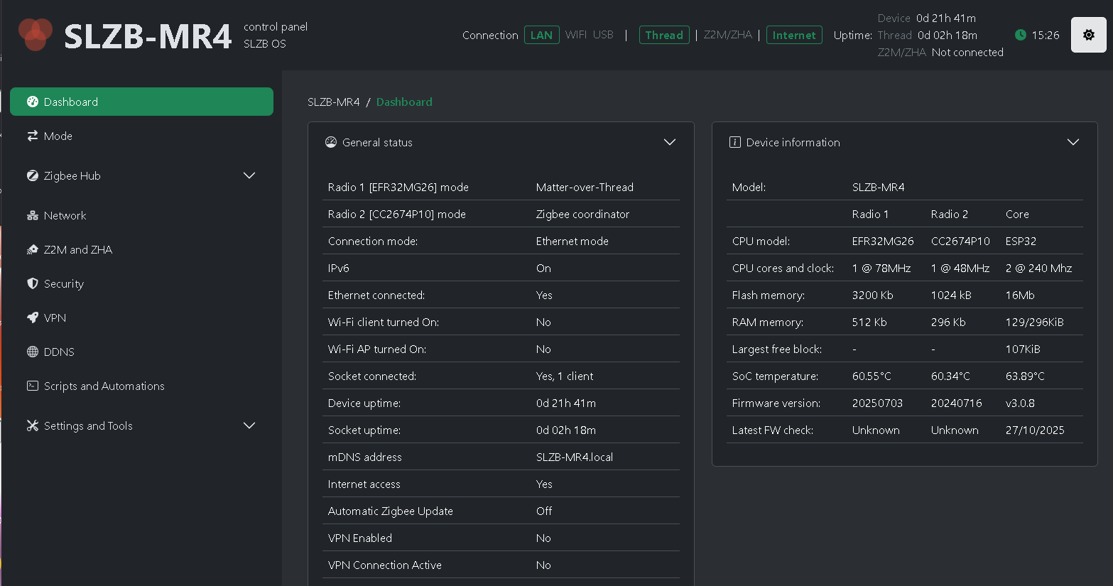

So I bought the Aqara lock and a SM Light SLZB-MR4 multi-radio since it would get me going with Matter over Thread… appraently.

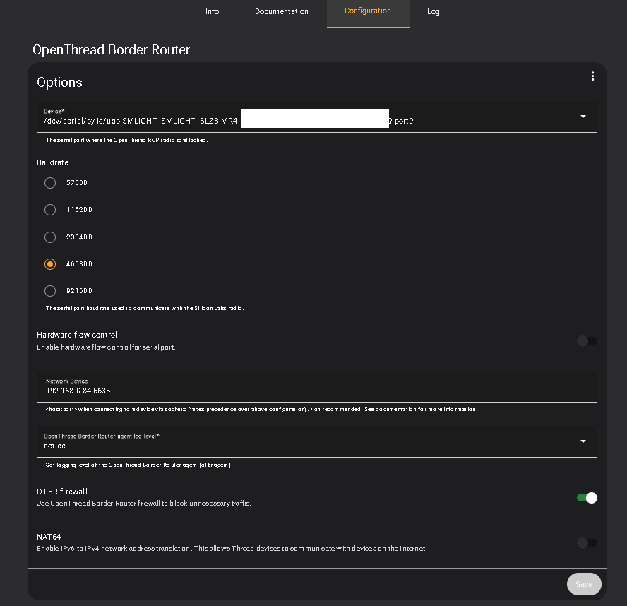

The SLZB-MR4 is currently setup with one radio of it’s two set as Matter-over-Thread and the other ZigBee (not using yet since I already have a ZigBee setup separate to this) and is connected both via USB to my HA Server and Ethernet to my Ubiqiti Dream Machine Pro.

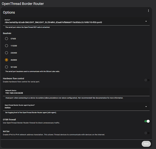

Initially I tried setting up the MR4 to connect to HA via USB but things werent’t working well so I swapped to Ethernet.

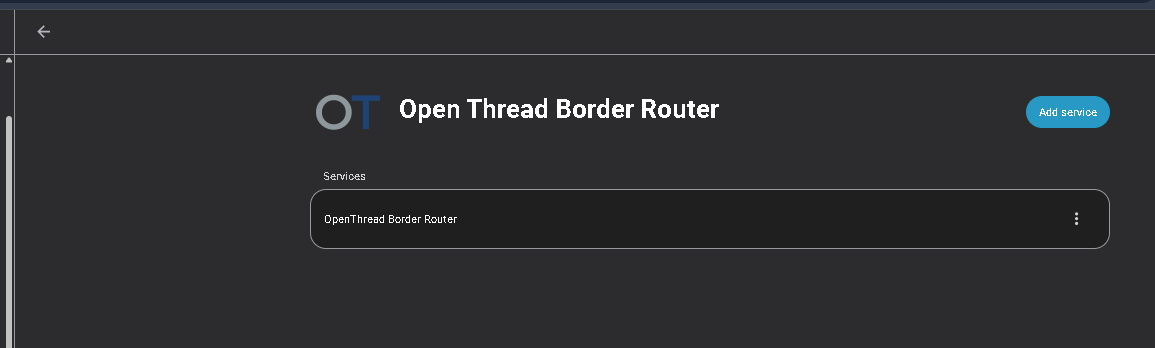

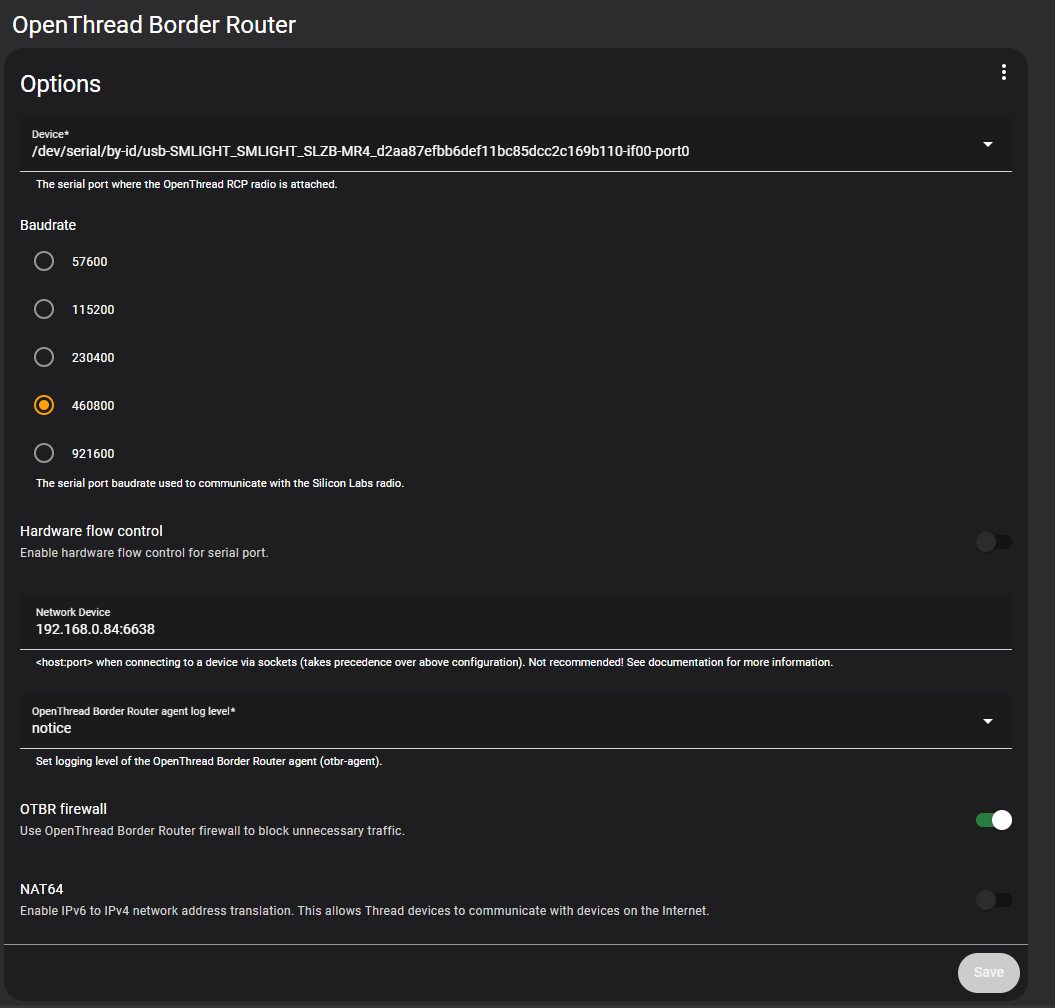

I’m running HAOS on a NUC, I have the Matter server add-on installed, the OpenThreadBoarderRouter add-on and integration, Thread and Matter Integrations, have done multiple synchronisations of the Thread credentials to my Android phone and still cannot get the Matter lock to connect. Needless to say, it’s driving me insane. I normally have everything under control with my smart home / HA but has cooked me.

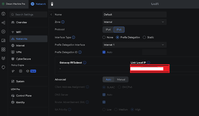

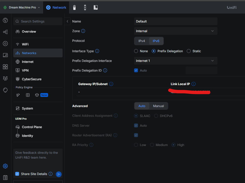

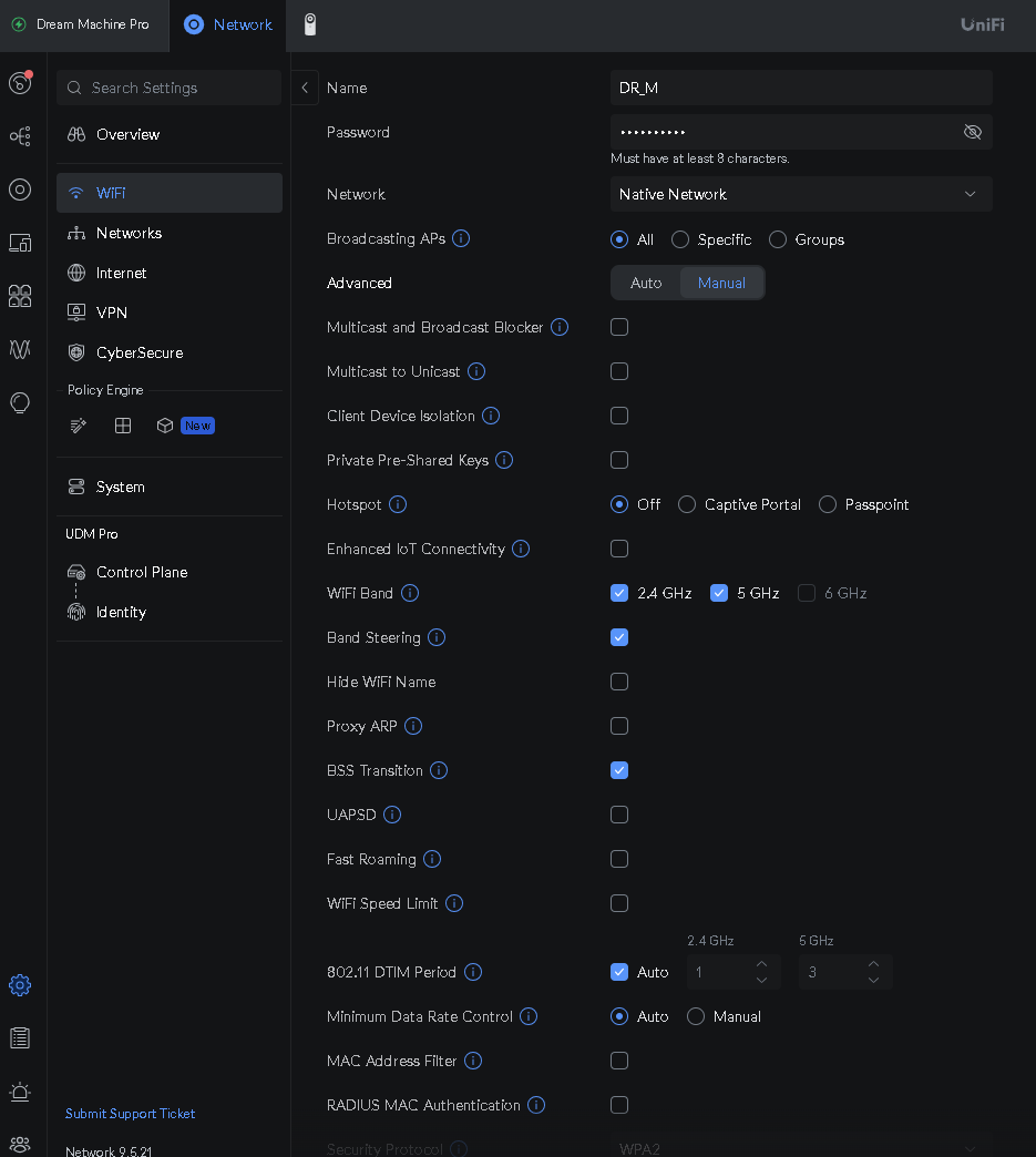

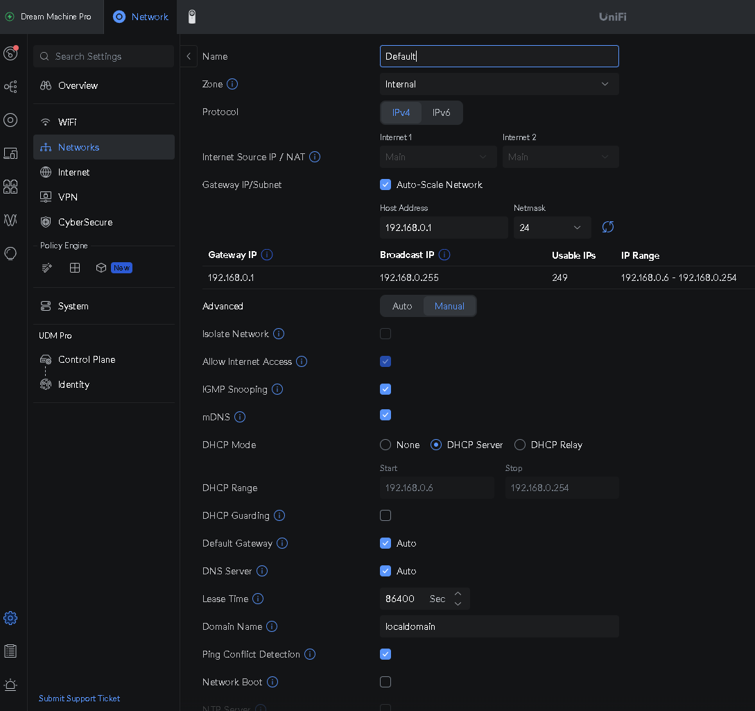

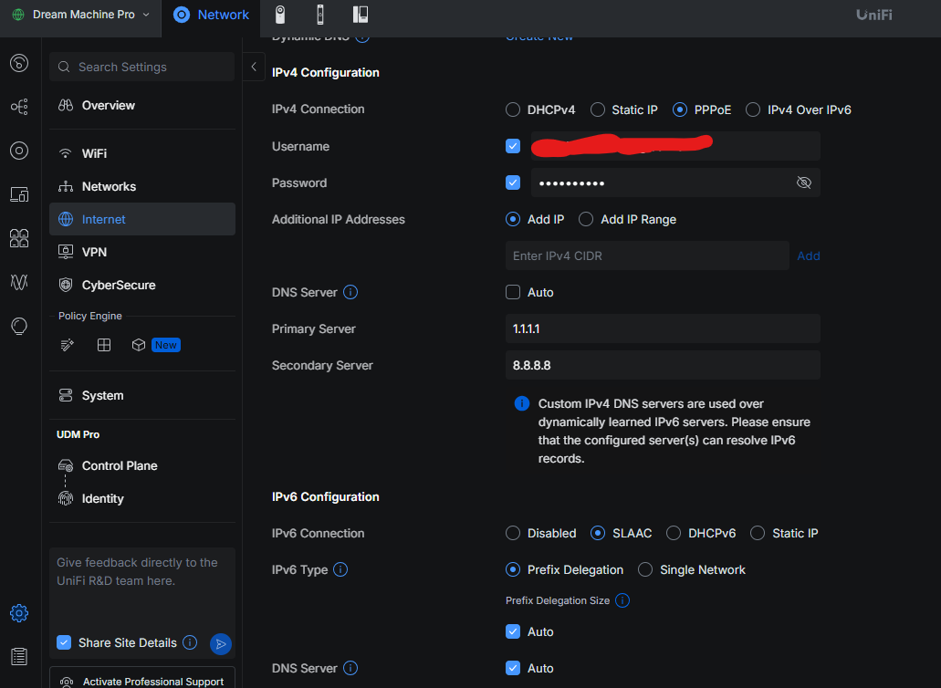

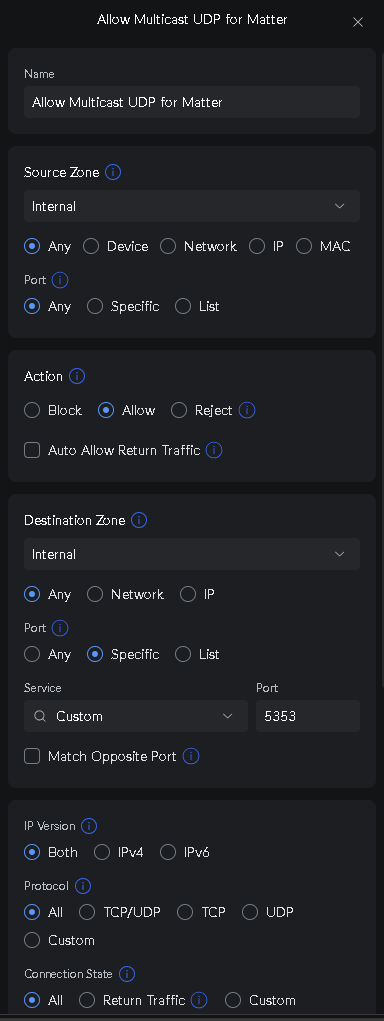

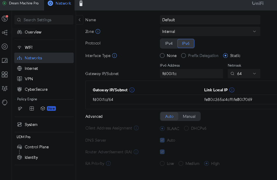

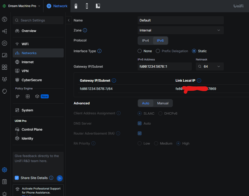

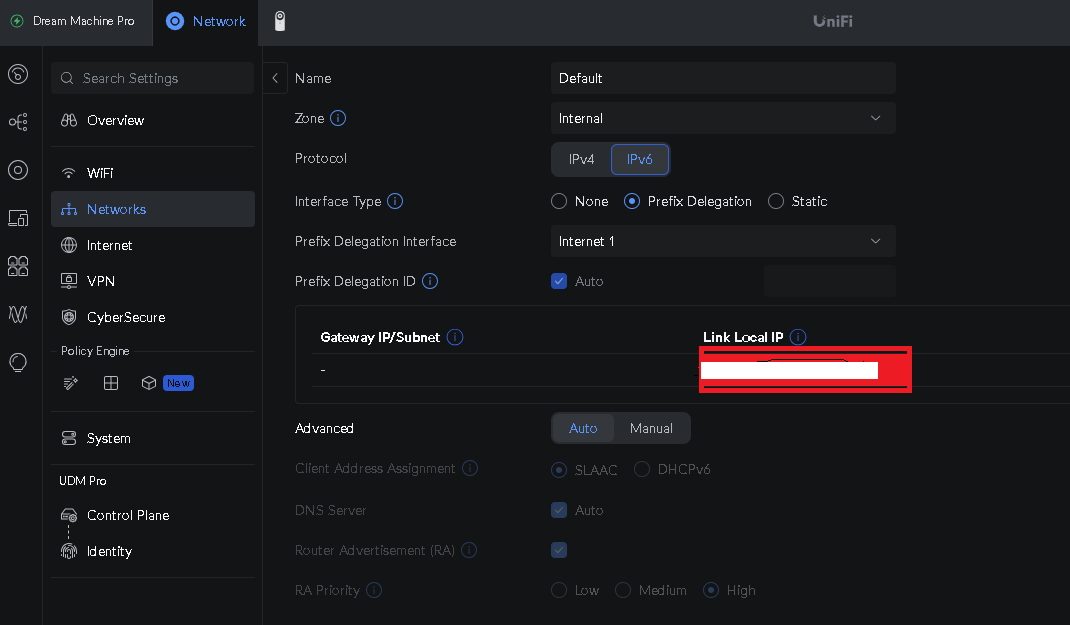

In my UniFi setup, I’ve enabled IPv6, the HA server and my phone are on the same network and VLAN, as well as the SLZB-MR4 device.
Here are some screenshots of configs etc.
SLZB config:
Router:

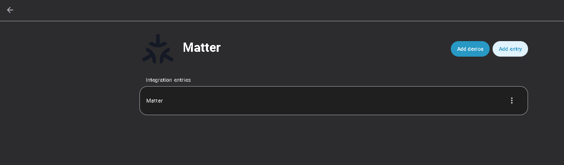

Integrations:
I am at a total loss as to what to try next. When I try to add the U300 lock using Matter in the HA Companion app on my phone, it seems to detect the lock and creates Matter credentials, then goes to 'checking network connectivity or something…then times out saying to check the device is compatible.
Any tips on what to try next before giving up on Matter completely and sending this lock back? (a bit more of my chaos posted here)

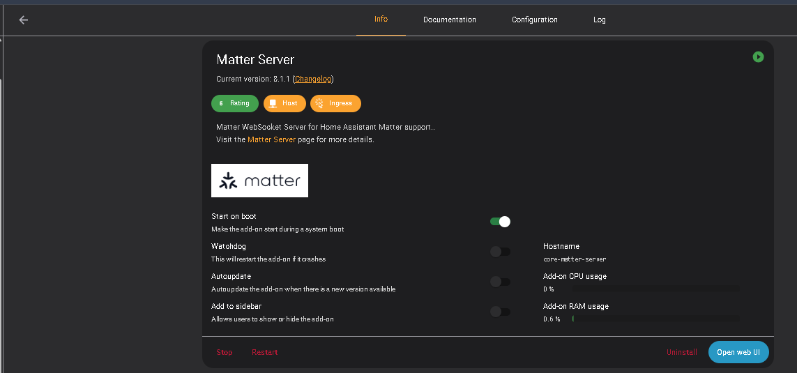

I’m not an expert on this, but just a few points to exclude or narrow down the problem:
  • You should probably activate Watchdog for the Matter Server AddOn to restart if something goes wrong.

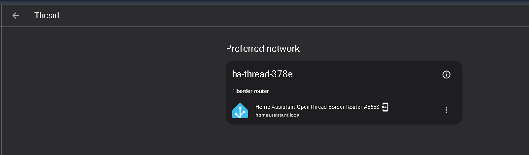

  • This is your first Thread device you are connecting, right?

Done now, thanks.

I’m no longer using the USB connection for this device since I had no luck initially, now it’s connected via Ethernet and simply powered by USB (which is connected to the HA server for ease of swapping back if needed)

[NOTE]-AGENT---: Radio URL: spinel+hdlc+uart:///tmp/ttyOTBR?uart-baudrate=460800&uart-init-deassert
[NOTE]-AGENT---: Radio URL: trel://eno1

I think the problem is the OTBR is repeatedly seeing RCP failures which suggests it is attempting to talk to the SLZB’s RCP and is unhappy with what it sees.
I don’t know much about this device, but I presume it has two paths for a protocol stack to talk to it since it is dual-protocol; Either two serial ports (via one USB) or two TCP/IP ports? Is it possible the OTBR is talking to the wrong port?
With the SLZB, I first tried to have it setup via USB to my HA server and it was/is detected etc, however the Thread network didn’t seem to connect so I changed the settings to use it via Network. The device still has the USB connected to the HA server. I used this guide.
Here’s the config I used for it in the OpenThread add-on:
I just noticed new errors in the OpenThread Boarder Router add-on log too:

Looking up that error the common issue is that when using a co-ordinator in multi-protocol its acting up. I would do a verification test to see if setting to Thread only mode will alleviate this issue. (this is one reason why I have dedicated co-ordinators in my setup instead of a multi setup just to prevent issues like this).
It looks like theres no option to disable a radio completely. I have the second radio (the one I’m not using for Matter over Thread) set to ZigBee coordinator but haven’t set it up in HA at all.
Since my ISP doesn’t provide IPv6 connectivity, maybe my IPv6 LAN settings are wrong?
In my UniFI config I have this:
EDIT: After some further research into IPv6 I changed things, disabled IPv6 on the WAN side and put the below settings in for the LAN.
For some reason though my HA server seems to have lost internet connectivity…
I feel like I’m getting somewhere… slowly.
I have IPv6 somewhat sorted on my Unifi network, in that my HA server (and a number of other devices on my network) has been assigned an IPv6 address, but the SLZB-MR4 radio hasn’t even though IPv6 is enabled…
Any ideas? I feel like this could be my last hurdle…

I was about ready to launch the Matter door lock into outer space after HOURS of ChatGPT and Googling to try and get things to work, but I finally had success.
As long as the IPv6 stuff is sorted, I found the below worked.
I had to add this Firewall rule in the UDM Pro to get the final piece of the puzzle:
