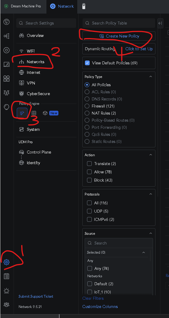

@sparkydave Have you upgraded your UDM Pro to Zone Based Firewall?
I’m not seeing the same options in my UDM FW config.
My UDM is on Network version 9.5.21. It has both zone based and rule based options for the firewall creation.
Had to activate the new zone based option, that got it going.

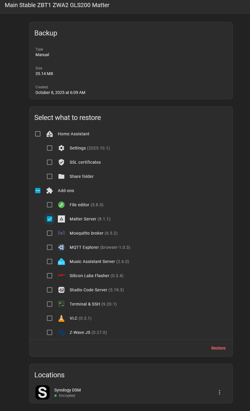

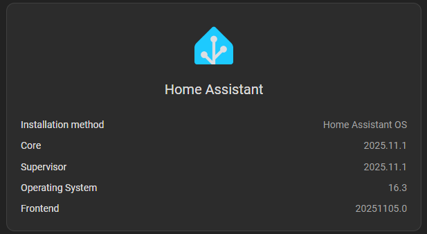

Just to post up an advisement for anyone that is looking into this thread as well:
If you have offline devices after updating to 2025.11.1 for Core and Supervisor of you HA instance with 8.1.1 build of Matter and if you do have a manual backup or autobackup from before the update to your instance to HA then do a restore of just the Matter addon, this will restore all devices back to an online state.
