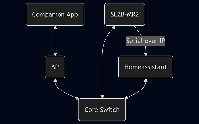

Infastructure:
Homeassistant running on a dedicated server only one nic.

So from my understanding:
  1. Phone connects with bluetooth to M-T device
  2. Thread border router commisions device via phone BT ?
  3. device should join thread network.
Since it is Matter over Thread and not over Wifi, the device should not connect to wifi at any point, correct?

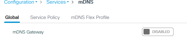

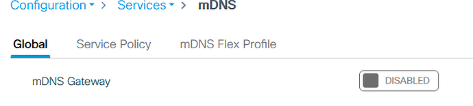

So for everyone who will be reading this in the future:
The issue was with Cisco WLC 9800 using the mDNS gateway feature on the WLC only predifined mDNS services gets forwarded. Matter stuff is not included in there, thats why it does not show up anywhere in the wifi infrastructure, it probably is possible to add everything but there is another way. To have that function with Cisco WLC, APs need to be placed in flex connect mode with local switching. Create a SSID in the same VLAN where you have your homeassistant.
In the SSID settings check mDNS Mode : Bridging
In global setting mDNS gateway needs to be disabled
