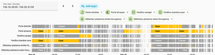

After a couple of days, I saw that the sensors went sometime in a state “unavailable” for a couple of minutes. Then, it occurred more and more, so that the devices are sometime available only 10% of the time. When this hapend, all the devices are set to “unavailable”, at the very same time, but the recovering the devices may happened faster for some devices. Here is a picture:
At night, my wifi is turned of, and the issue still occurred, so I ruled out an interference issue. I guess this problem is not also on the side of the IKEA Hardware, because all devices are displayed as unavailable at the same time. I image this could be a problem with the mater server of the firmware of the ZBT-2.
