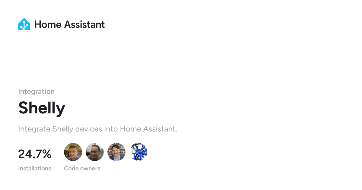

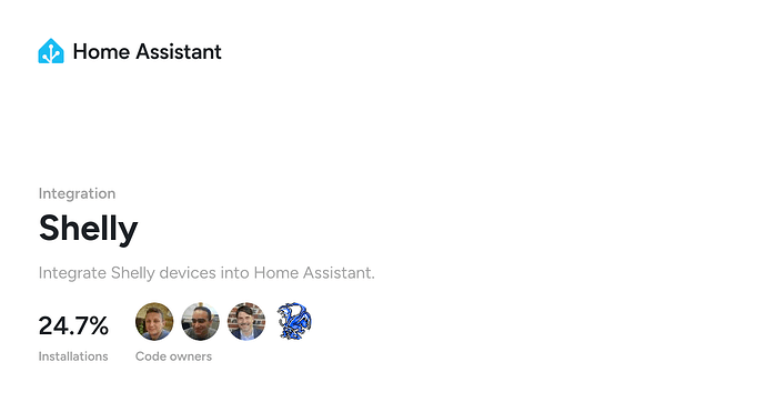

PS: If you want your Shelly in HA only as an IP Device, use the Shelly Integration
I Would recommend that you use the Shelly Integration, as you loose functionalities/entities when adding it to the Matter Integration
