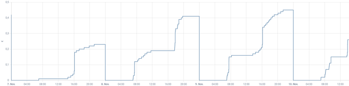

I have a sensor, which counts the gas/energy consumption over the whole day and resets on midnight (see below). Now I want another sensor, which gives me the total energy consomption for the whole day, e.g., the max value from the sensor shown for a wohle day. It is possible to get the max value for the last 24h hours, but I need the max-value from midnight to midnight? I possible, I don’t want to work with automations, since the data might get broken, if Hassio doesn’t work at midnight (due to server restarts, backup etc.).
