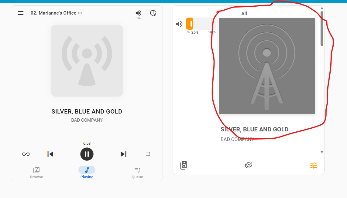

How do I get rid of this (it appeared after the 2nd to the last upgrade):
Looking to have just the volume controls.
Thanks
You need to upgrade to the latest version of the card.
I hope you enjoy this card!

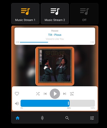

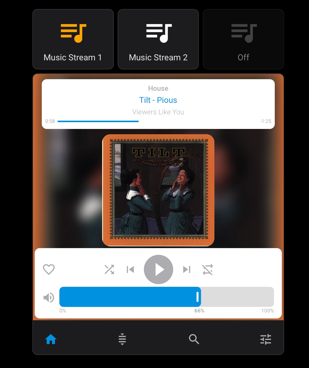

This card is amazing! I’m trying to figure out if I can make it do what I want though. Here’s my setup-
I have 4 MA Players. However, they are all connected differently to speakers. 1 is a PiCore connected to the AVR in the living. 1 has an amp connected directly to speakers, and 2 are going through a multi-room amp and cab be played in any of those rooms.
I currently use Universal media players for each room along with templating to link the speakers and allow for the selection of a source.
For Example-
If Source 1 is selected in the office, it switches the multi-room amp source to the House PiCore player for the office speakers and the volume controls the amp volume for that room.
I’ve been using a different media player card along with variuos scripts and custom buttons, but I find it unreliable and slower than this one. I’m just trying to figure out how to get this to work where I can set it up and have the rooms activate correctly and appear correctly for control.
Is this possible in some way?
(I know I’m probably not describing it well, sorry).
Edit: I can use an input helper to select what source to use in each room, but I’m not sure how to then auto select which source to use on the Maxi Media Player.
If I select House PiCore Player using an input helper for the Office, it will automatically set the zone to the correct source and turn on the PiCore Player. But how can I then set the Maxi Player to show that player through automation or a script? Would I need to separate Maxi Players, one for each possible source for the room that just doesn’t show the other?
Try the latest beta with config entityPlatform: music_assistant
Thanks for responding. That’s what I’m using. I think I’m pretty close.
I have to have a card for each source along with buttons to choose the source and turn it off. If Music Stream 1 is selected, it only shows the card associated with that source.
Behind the scenes is an input_select helper and a number of scripts. I had these all in place already so it was just a matter of figuring out the card and the logic for the buttons.
I wish I it could dynamically swap the source on the card (template for the entity_id?) so I only needed one card, but this is pretty good!
