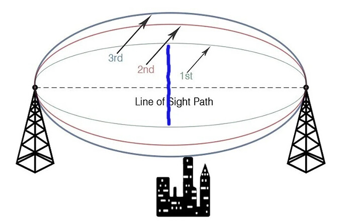

Perpendicular positioning
It’s possible to enhance the sensitivity of the detection by positioning the sensors so that the area you’re interested in detecting is perpendicular to the direct line-of-sight path between the two sensors, ideally within the first Fresnel zone where signal interaction is strongest.
Think about this when installing the sensors in your room. When installing sensors in the bedroom, for example, put one on each nightstand at both sides of the bed in order to detect you sleeping in the bed, as you’re then lying perpendicular to the direct line of sight path and within the first Fresnel zone. Or when installing sensors in your home office, place them so your chair is perpendicular to the direct line of sight path and centered between the sensors for optimal detection.

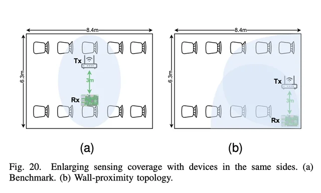

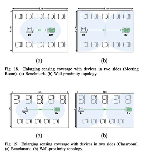

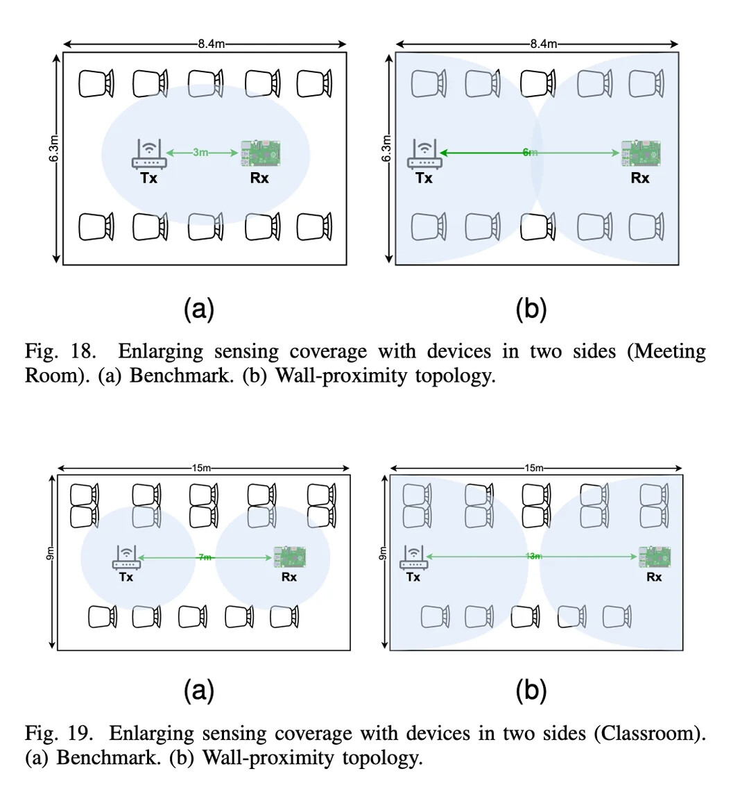

Wall-Proximity matters
It’s possible to enlarge the effective sensing area by placing sensors near walls (Reference: https://arxiv.org/pdf/2412.13208). You can see some examples below.
