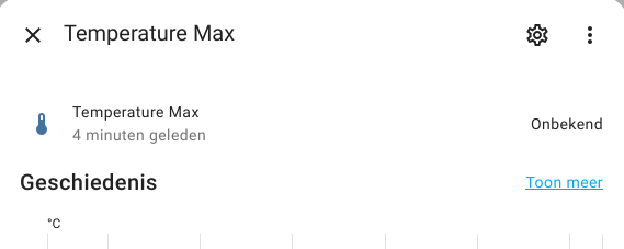

hi all,
looking ot get this working too. (to check on my cell phone what the actual temperaturen outside is and what it will be at the warmes point of the day - so I know what to wear :slight_smile: )
unfortunately this doesn’t work with me ?
I copied the code above in my configuration.yaml , but changed the name (since the met.no forecast sits in weather.forecast_thuis .
template:
  - trigger:
      - platform: state
        entity_id: weather.forecast_thuis
    action:
      - variables:
          w: weather.forecast_thuis
      - service: weather.get_forecasts
          type: daily
          entity_id: '{{ w }}'
        response_variable: r
    sensor:
      - name: 'Temperature Max'
        unique_id: 'temperature_max'
        unit_of_measurement: '°C'
        device_class: temperature
        state: "{{ r[w].forecast[0].temperature }}"
the template sensor (don’t know if I call it like that?) shows up between my entities:
but the values stays empty :frowning:
every help is appreciated

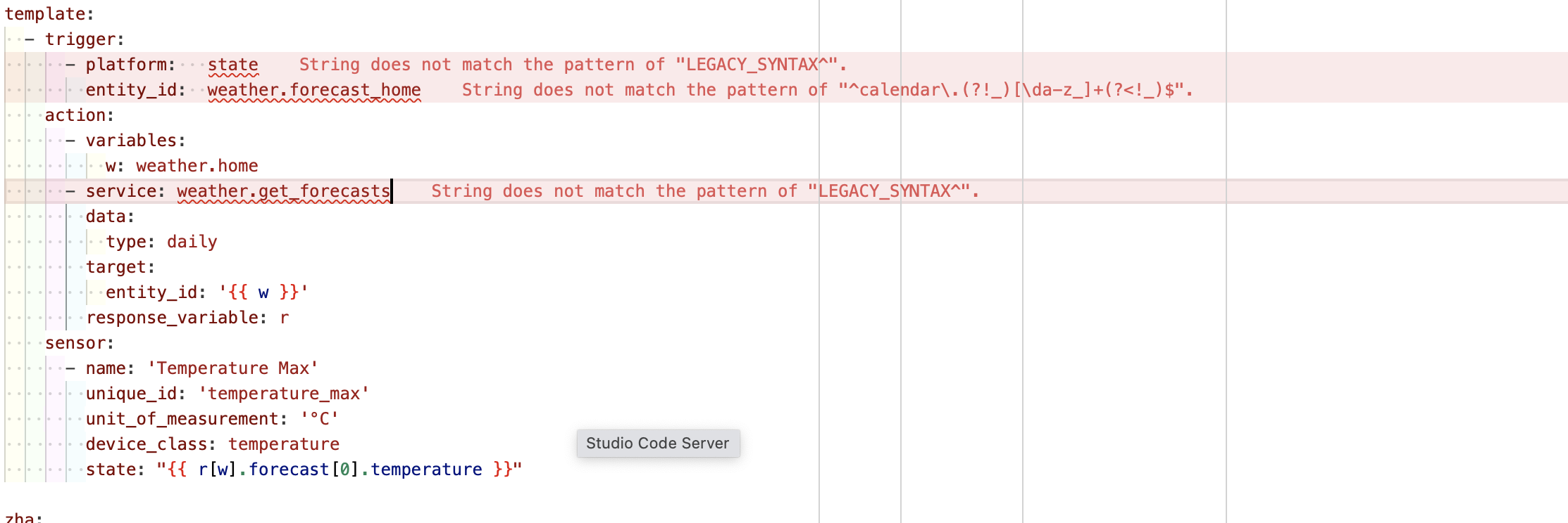

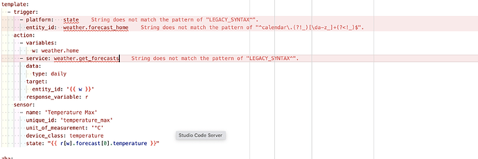

Okay, here is a snippet from my config.yml
Not sure what I’m doing wrong.
All I’m trying to do is the high and low forecast temp for the day. Maybe I’m going about this all wrong.
You’re using the Visual Studio Code add-on which includes Config Helper which adds validation features specific to Home Assistant.
One of those validation features is to identify invalid YAML syntax (as used specifically by Home Assistant). In the screenshot you posted, it is complaining about the use of platform: and service: in the example’s configuration.
It’s an old example (over a year old). It predates Home Assistant’s change from using the word platform: to trigger: and from the word service: to action:. In addition, the word trigger: was changed to its plural form triggers:.
The updated version looks like this:
template:
  - triggers:
      - trigger: state
        entity_id: weather.home
    action:
      - variables:
          w: weather.home
      - action: weather.get_forecasts
          type: daily
    sensor:
NOTE
Home Assistant still supports the use of platform: and service: so it’s not absolutely necessary to update old examples. It’s only Config Helper, in Visual Studio Code, that identifies them as being problematic. However, if want to eliminate those red warning messages in Visual Studio Code then you’ll need to update the example.

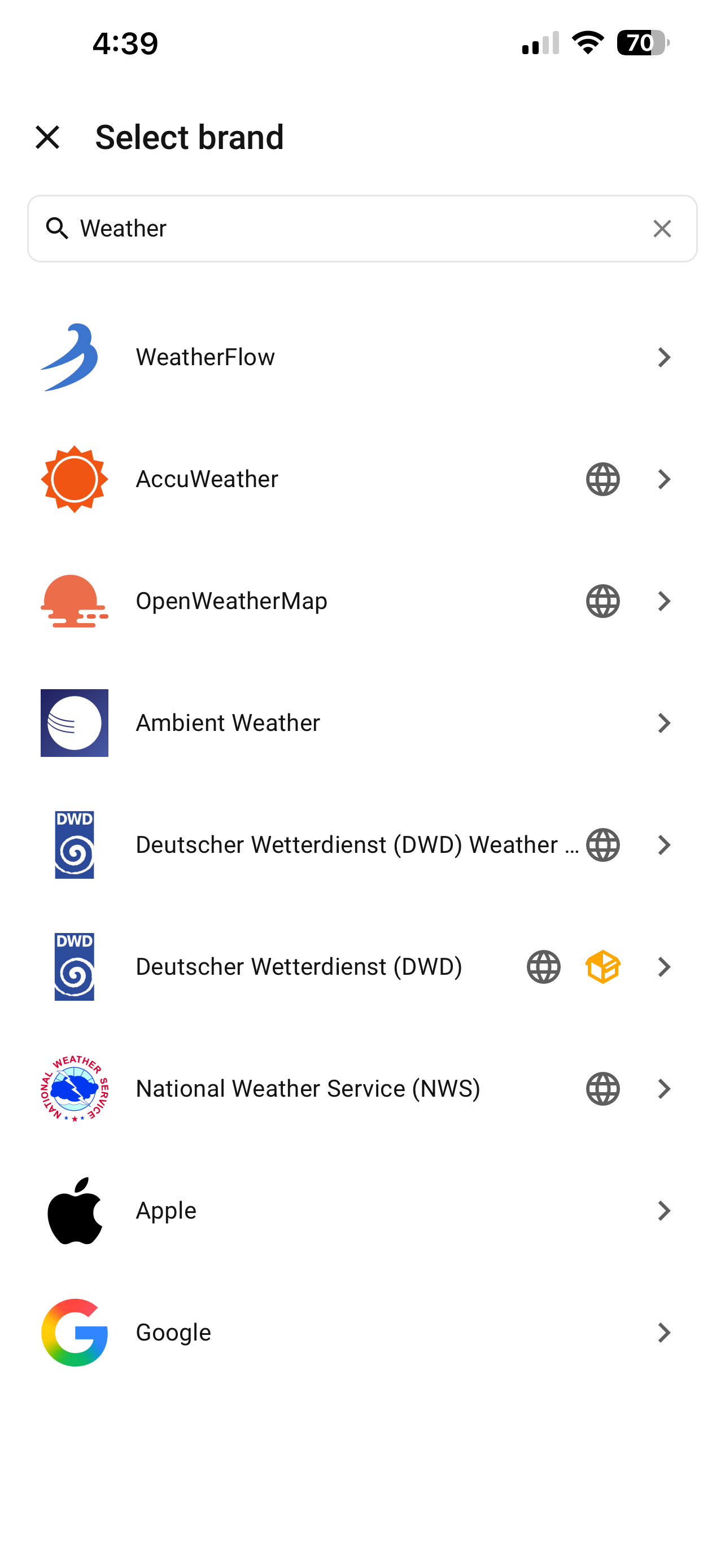

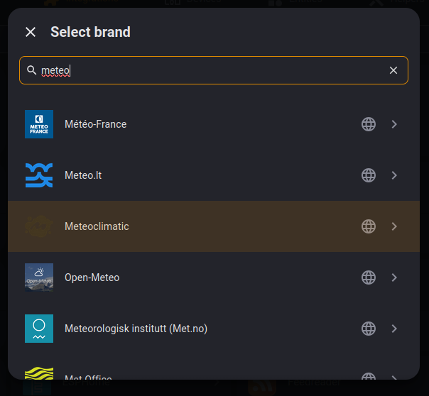

The link shows a bunch including one called ‘weather’? This is what I have:
Doesn’t have half of the integrations listed on the link.
What am I doing wrong?
Nothing... except maybe expecting a search for the word "Weather" to return things that don't have that word in them:
Not all of the integrations shown in the link I provided are weather providers... some are for weather station devices. The page doesn't have a way to narrow down the category to just provider integrations.
That is the Weather "Building Block" integration that all other weather-related integrations rely on... it isn't an integration you install directly yourself.
Doh! Obvious now! :grin: I’ll take another look.
