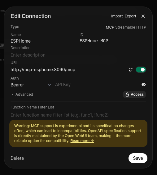

I have the docker running on Portainer and connected to ESPHome. But connecting it to Open WebUI hasn't worked yet. Seems to me that the issue is that the docker image doesn't support OpenAI connection types?
How are you connecting it?
It should be added as a tool server.
and
  # ESPHome MCP native server
  mcp-esphome:
    image: ghcr.io/loryanstrant/esphome-mcp:latest
    container_name: mcp-esphome
    restart: unless-stopped
    environment:
      - ESPHOME_DASHBOARD_URL=${ESPHOME_DASHBOARD_URL}
      - ESPHOME_API_KEY=${ESPHOME_API_KEY}
    networks:
      - webui-net
  # mcpo bridge for ESPHome MCP (HTTP type)
  mcp-esphome-proxy:
    image: ghcr.io/open-webui/mcpo:latest
    container_name: mcp-esphome-proxy
    command: [
      "--port", "8090",
      "--type", "streamable_http",
      "http://mcp-esphome:8080/mcp"
    depends_on:
      - mcp-esphome
    networks:
      - webui-net
