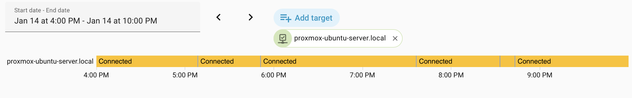

To diagnose I also set up a Ping sensor and I’m seeing brief failures on a regular basis (but not an exact interval):

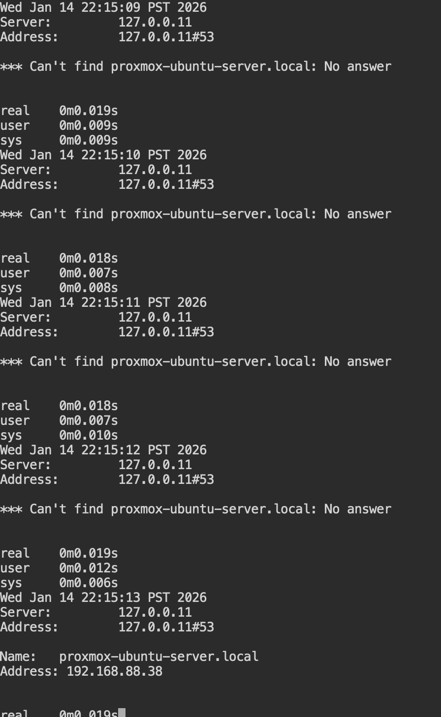

And I also ran nslookup proxmox-ubuntu-server.local in the HA terminal once per second in a loop, and saw these “No answer” errors around the same time that the ping sensor disconnected:

Also curious what makes you say this is an ipv6 specific issue – I see the ipv6 address in the “Connect call failed”, but does it also explain why nslookup would fail?
Yes, you probable need to disable it in all VM’s (You can disable it in the HA Network settings). Did you check your /etc/resolv.conf file? In virtualized networking the host often proxies the DNS. If it used a IPv6 address for that this could be a problem.
