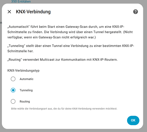

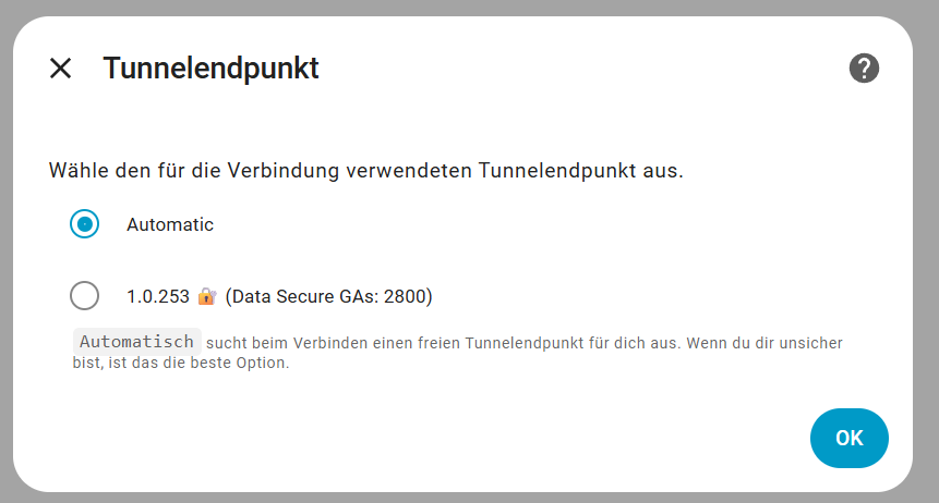

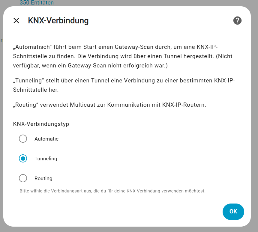

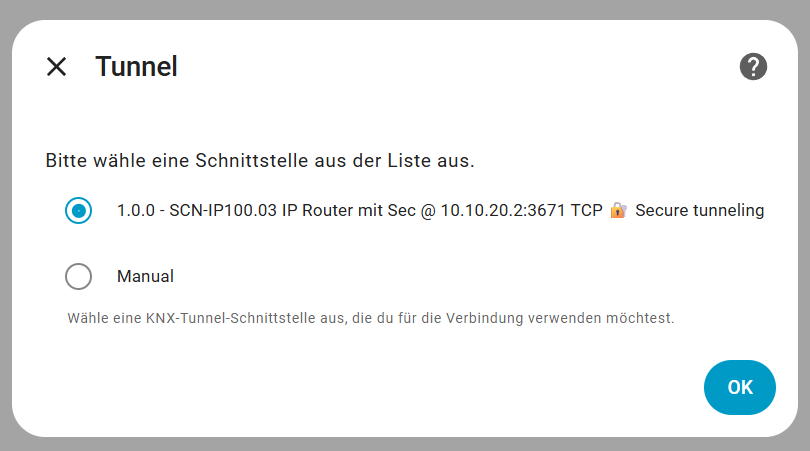

For all others these are the steps that I selected in the HA wizard:
