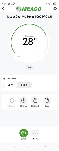

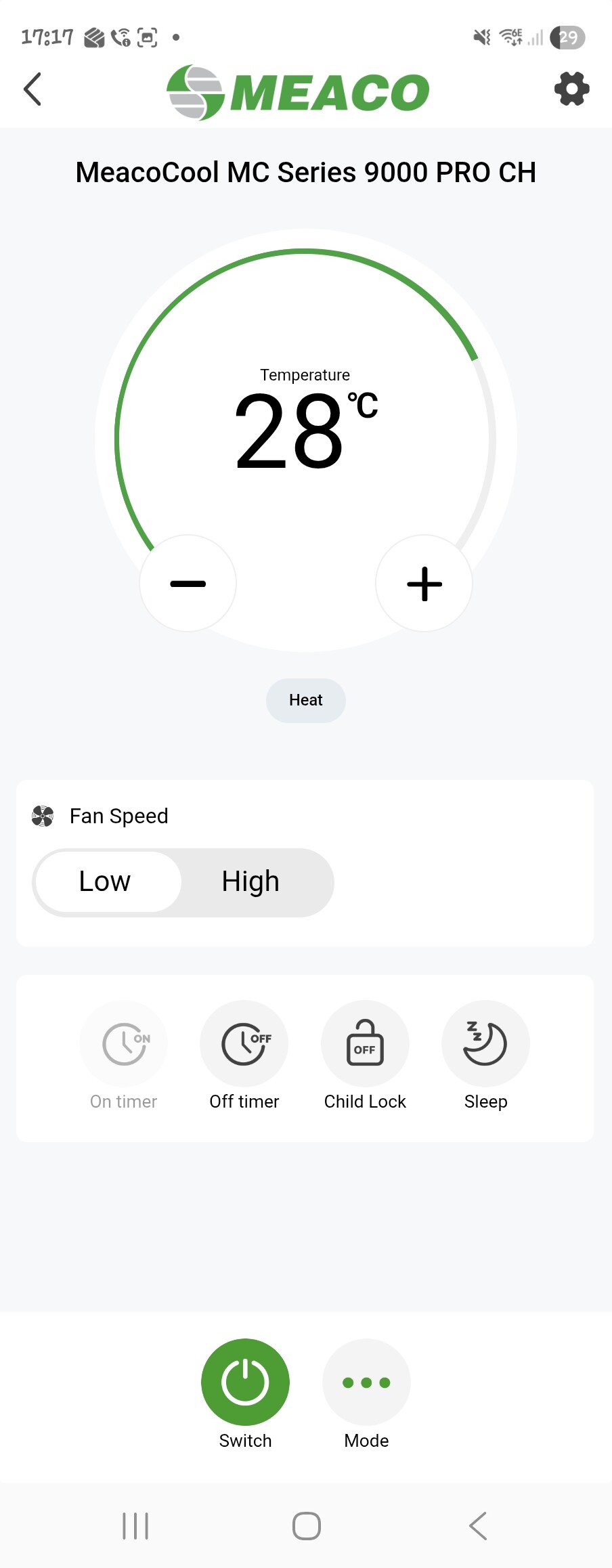

Just wanted to let others know that the above works with the tuya app. Just need to press and hold timer button on top and a wifi logo flashes and after a few tries it finds it on tuya app add new device. The display looks similar on the tuya app.
With the tuya cloud integration on home assistant it appears automatically with the temperature working. Off turns it off, but it needs the tuya app to set the mode and get fan to run again.

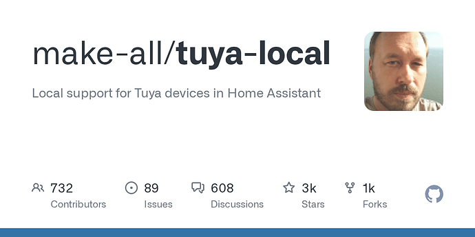

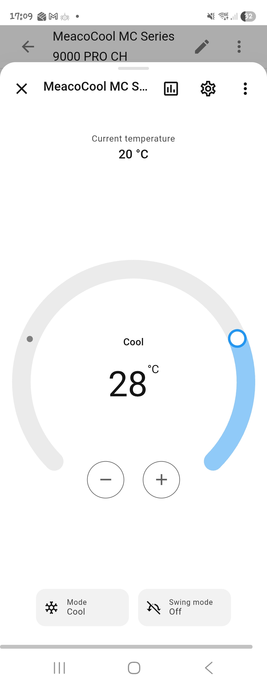

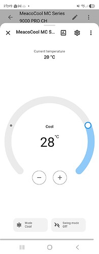

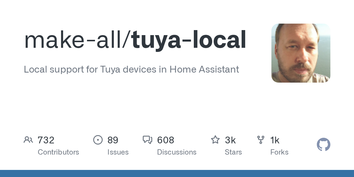

All the functions work with Tuya-local automatically, simple setup
It gives an option to support swing mode which isn't implemented - but this isn't a problem
Just needed to give it a defined IP via DHCP on router settings to stop it getting lost
