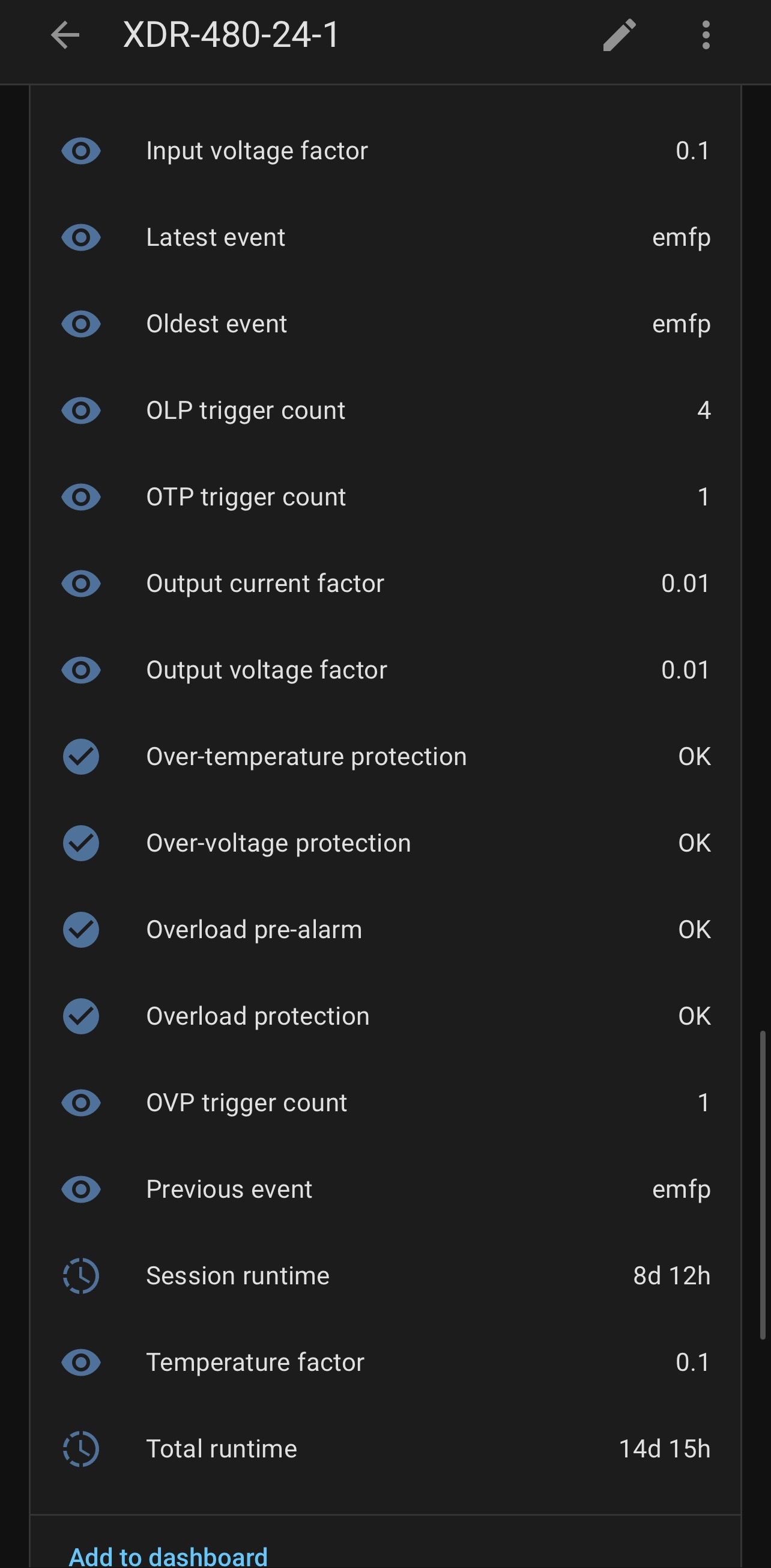

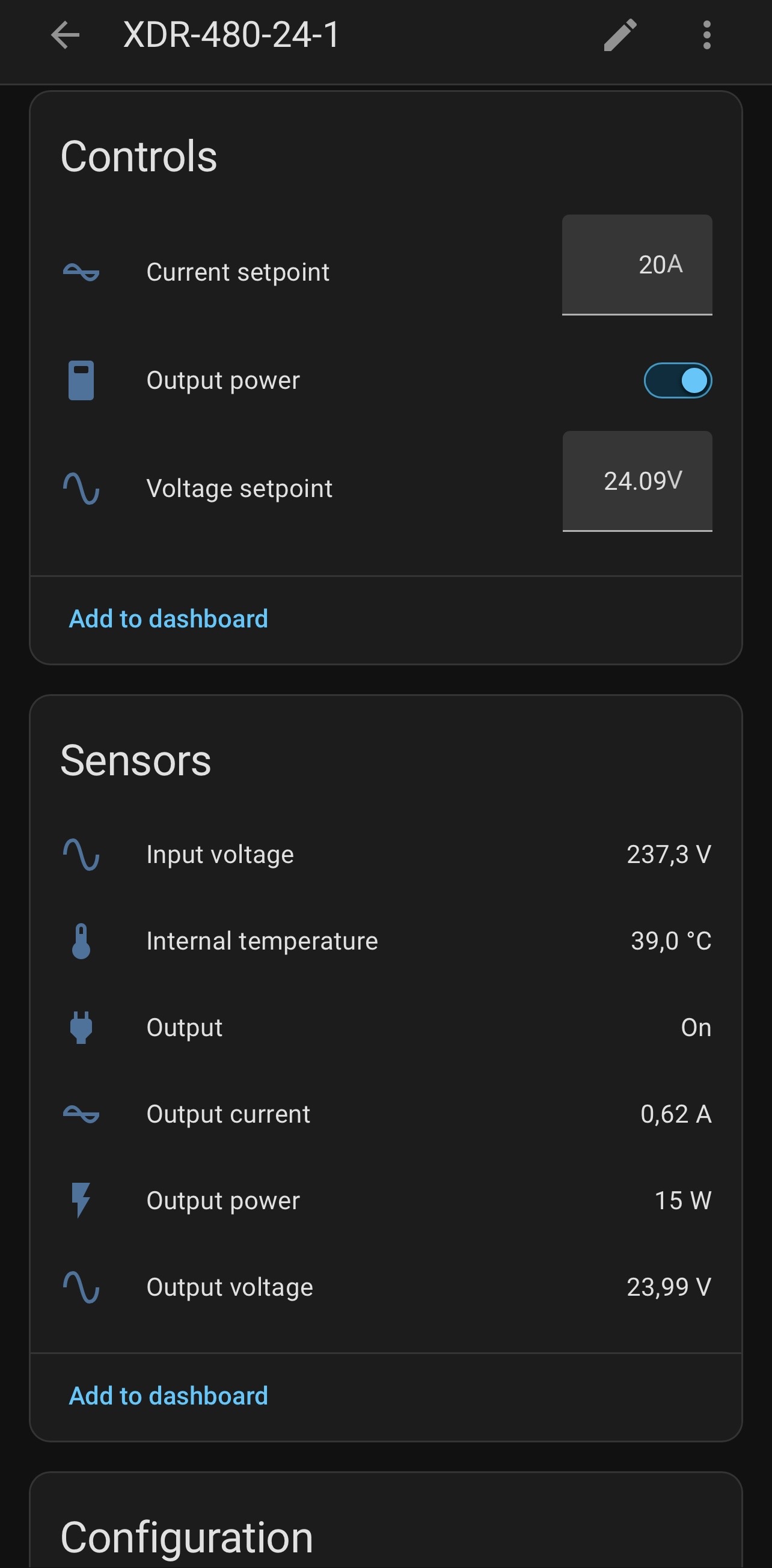

Real-time monitoring: input/output voltage, current, power, internal temperature, live scaling factors.
Control: output on/off, voltage & current setpoints with model-aware limits, modbus control toggle (switches between potentiometer and digital control), AC failover thresholds, DC OK threshold, peak current limit.

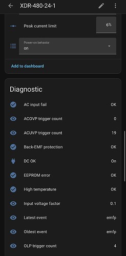

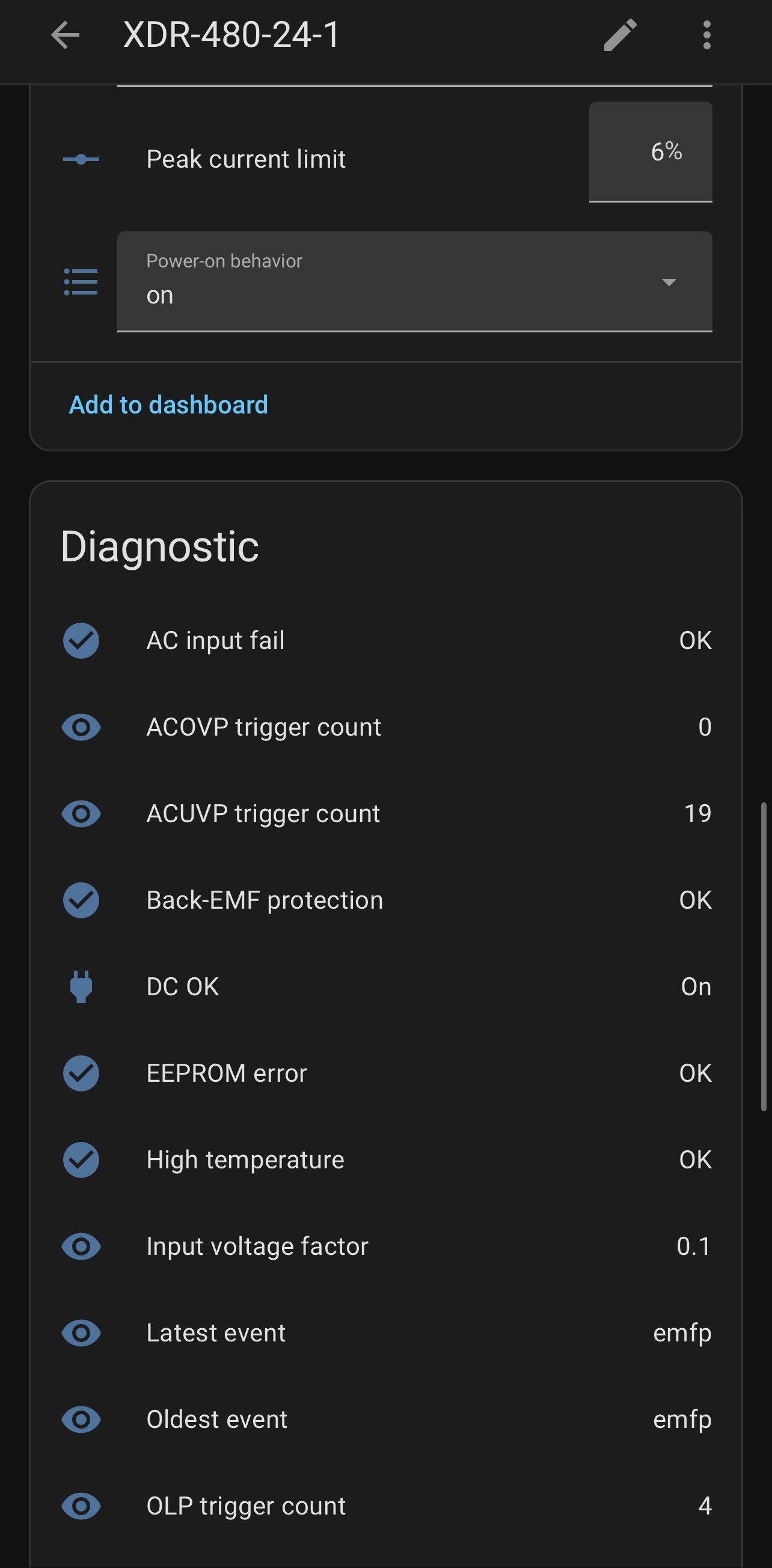

Diagnostics: OTP, OVP, OLP, AC fail, back-EMF, overload pre-alarm, EEPROM error as binary sensors; trigger counters for every protection event; 3-deep fault event log.

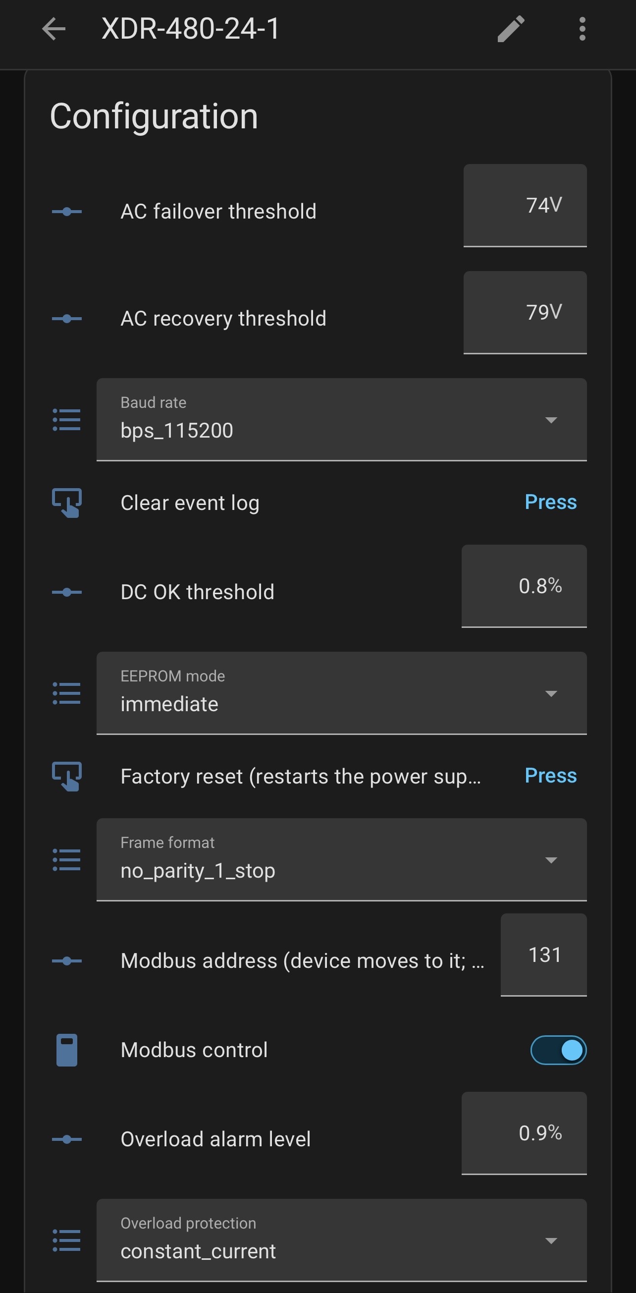

Configuration: baud rate, frame format, power-on behavior, overload protection mode, EEPROM mode, Modbus address. Factory reset and clear event log buttons.
Runtime: session and total runtime tracking.

Two XDR-480-24 units, Modbus TCP via an RS-485-to-Ethernet adapter. Slave addresses 131 and 132. I can now see at a glance which one is active, adjust the master by nudging voltage setpoints, and have peace of mind that if one fails the other keeps the lights on.

• Output switch & setpoints need MOD_CTRL enabled, then an AC power cycle to take effect.
• Factory reset restarts the PSU and restores defaults.
• Changing Modbus address moves the device - edit the config entry afterward.

Few screenshots:
