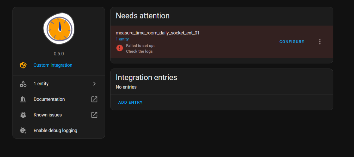

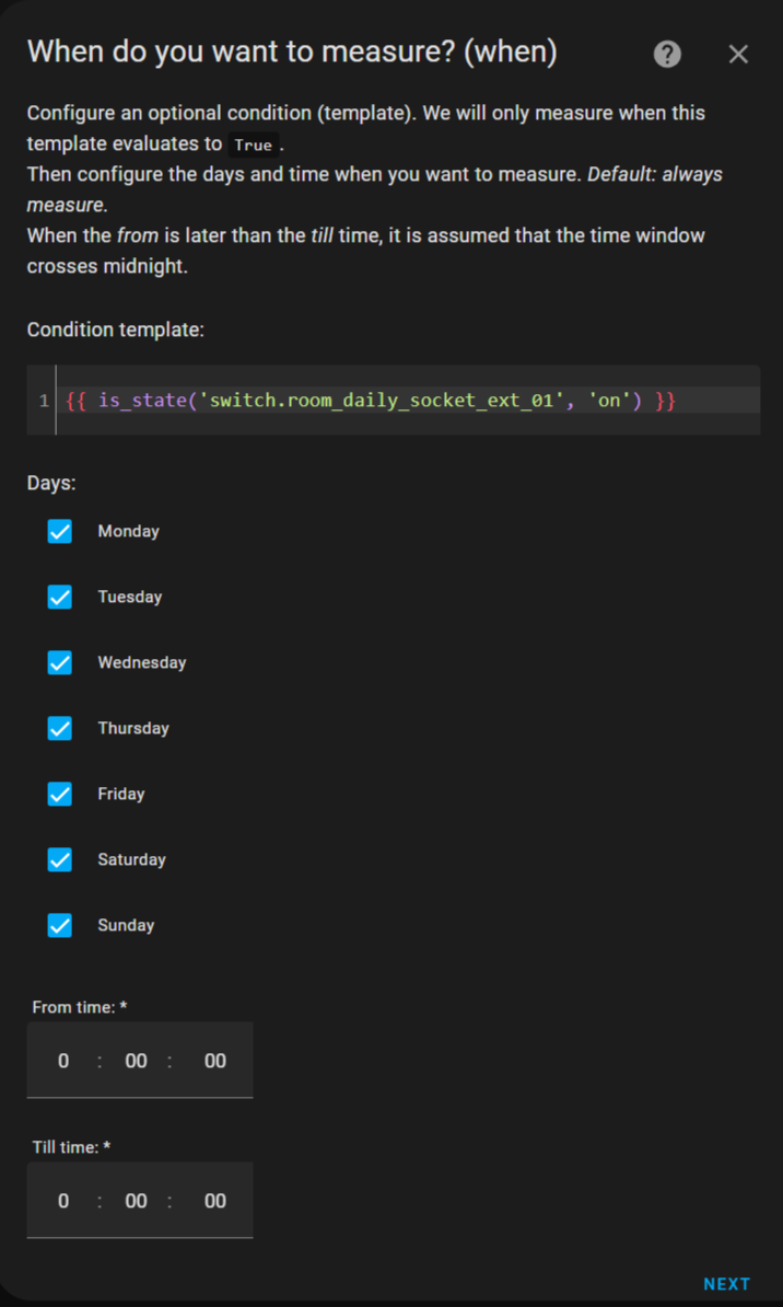

Why I can’t create measureit time sensor?
Here is configuration:
I’m just not sure what it would mean to edit a sensor template. You suddenly measure different things and the history of your sensor doesn’t make sense anymore. Why wouldn’t you just create a new one then?
You let me guess without providing the logs, but I think the reason is that timestamp_custom outputs a string that cannot be interpreted anymore by the device class and UoM.
