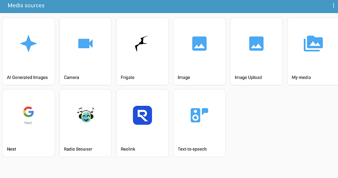

Issue: NAS-mounted folder does not show up in Media browser, and unable to trigger camera.record on it via DevTools.

Media browser also doesn’t show the location /media/cam_recordings

  1. local: /media mapping in media_dirs isn’t required. By default, HA seems to map anything in /media under /media/local. External mounts or other non-config folders (/config) can or should be, if required, accessed by specifying full path like so testing: /mnt/base_root/child/branch/xyz.abc for reference later in media-source or image or video etc.
