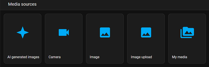

Choosing Media from the sidebar takes you here:
‘Camera’ - I get. It simply opens a view on all cameras.
‘Image’ - What exactly is that? Currently it contains a QR code for my WiFi that was created by my Unifi integration and it is actually an image entity. Which is all fine (I guess), but is a confusing folder name.

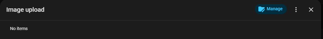

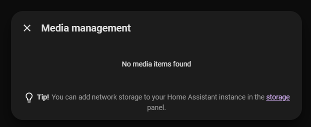

‘Image upload’ - Again, what is this? Mine is empty and the offer to ‘Manage’ in the top right leads to this, which is, yet again, confusing.
‘My media’ - This makes some sense and at least ‘Manage’ allows me to upload media, but what actually has access to it because I couldn’t use anything in here on a dashboard (I haven’t tried templates yet but I am guessing it will be the same?).

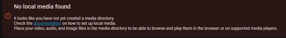

‘AI generated images’ - This is a good one! Firstly, what is it? Secondly, if I click into it get this:
“It looks like you have not yet created a media directory.” - Then where on earth am I looking at right now?
I won’t reproduce it here but clicking the link to the docs is absolutely no use whatsoever in unravelling this.

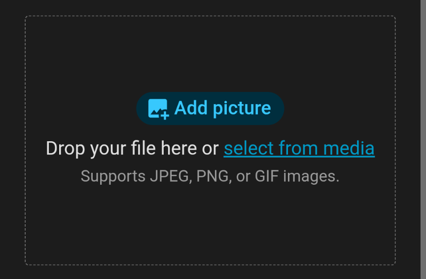

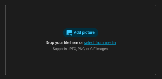

Going to Settings, People and clicking a person to add a picture gives this:
The picture has to come from the ‘media’ folder. If you click ‘select from media’ it takes you to here…

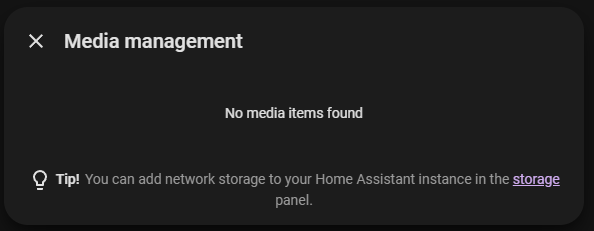

…clicking Manage takes you here…
…and then what?

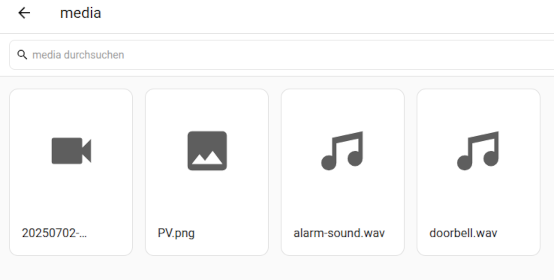

That works fine. For example, the following files are currently located under “My media” on my system.
If I want to insert an image into an image card and click on the image path, the “media” folder appears; I can then select the image (in this case, PV.png) and insert it.

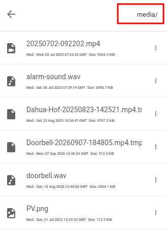

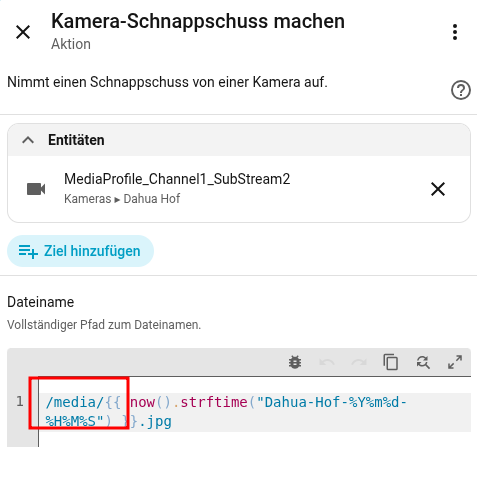

The files available under “My media” are located at the root under media/.
and can be opened from there; alternatively, files can be saved there - for example, via an automation. Here is an example where a camera saves snapshots to that location.

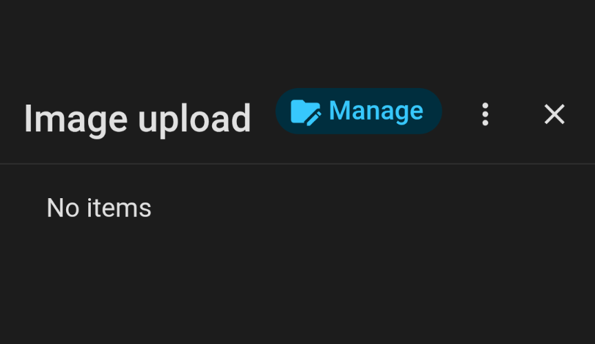

Now however, I find that the pictures have not carried across to the mobile app and what is worse I cannot even set them there, trying to do so takes me to the familiar…

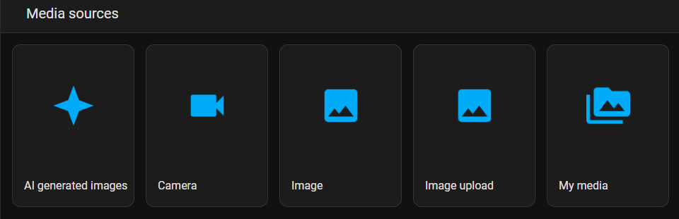

Choosing ‘select from media’, takes me here…
And, yes, you guessed it choosing ‘Manage’ gives me this…
Really? What is going on?
I’m assuming the media\Image upload folder is local, so that means every device will need to have it’s own copy of the pictures that are assigned to people.
Accepting the fact that is isn’t the worst issue HA has ever had[1], frankly this is an absolutely ridiculous situation.
[1] Except it is quite serious because people don’t appear on the map

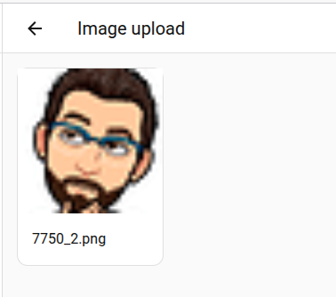

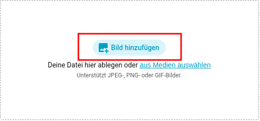

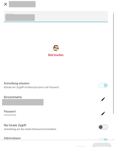

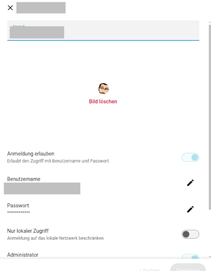

I can’t tell you what you can or can’t do with the HA app, because I don’t set anything up through it. However, the principle behind “Add,” “Upload,” and “Manage” is:
First, you need to add and upload an image.
Example for person:
It will only appear under Media → Image Upload once you have done that.

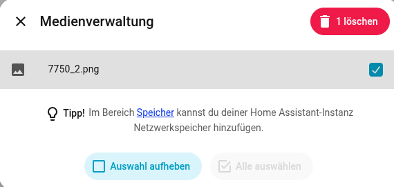

Under “Manage” you can only delete existing images - nothing else.
I can’t tell you where HA stores the data from “Image upload,” either. In any case, it’s not under Media/, or /homeassistant/image, or /homeassistant/www. But I’ve never really cared about that, precisely because I don’t use those two relatively new features - “Image” and “Image upload” - anyway. :slightly_smiling_face: Another user here will likely be able to answer the question of where the “Image upload” files are actually stored.
