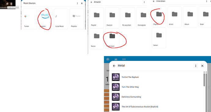

From the media player in Home Assistant, I can select the source (I’m interested in Amazon Music and local media). In both cases, when I navigate to a playlist or a folder containing multiple tracks, I can only select and play one track at a time.

I imported an Amazon playlist as a HEOS playlist, and the two behave differently:
In the first image, it’s the HEOS playlist — here I can play all the songs in the playlist by clicking the button at the top.

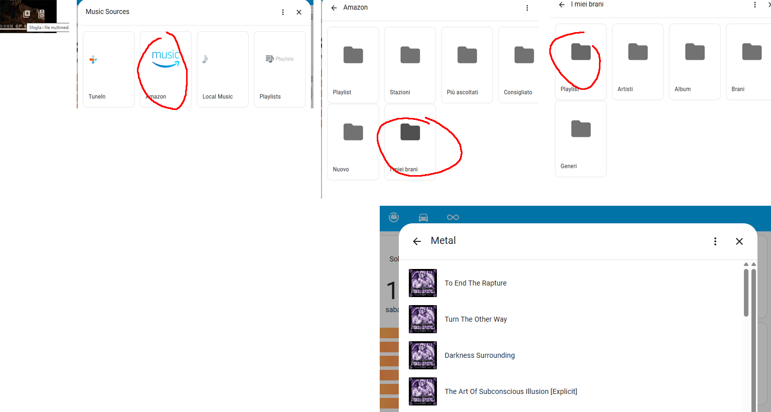

In the second image, it’s the same playlist but opened from Amazon Music → My Music → Playlists. There’s no button to play all the tracks.

You have 2 Playlist folders in those screenshots:
  • 1 under Amazon
  • 1 under “I miei brani”
What happens if you move the Metal playlist to the Playlist folder under Amazon? Does it behave like a proper playlist then?

The playlist folder under Amazon contains playlists suggested by Amazon, while the folder under “I miei brani” contains my own playlists created by me.
I cannot move my playlist from “I miei brani” to Amazon.
In any case, even the playlists suggested by Amazon have the same problem: I cannot play all the tracks, only the one I select.
