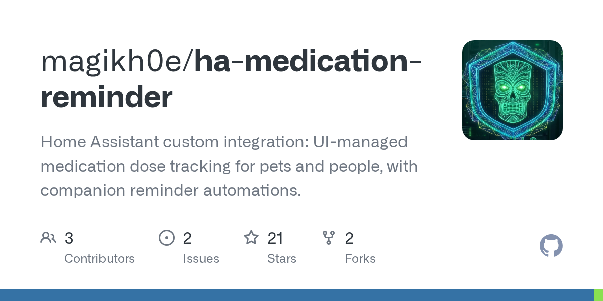

Small update: Medication Reminder is now in the default HACS store
For anyone still following this one: the integration got merged into the default
HACS repo today, so it’s no longer a custom-repository install. Open HACS, search
“Medication Reminder”, install, restart, done. If you added it as a custom repo
earlier, nothing changes for you, HACS just tracks it normally from here.
It sat in the review queue a while, and Frenck merged it in the end (and caught a
small manifest thing that I fixed the same day in 0.28.1).
Honestly, a big chunk of what this does came straight out of this thread. The
as-needed/PRN handling, the overdose guard, the supply and refill tracking, the
extra schedule types, the multi-language support, all of it started as someone
here asking “can it also…”. So thank you, genuinely. Keep the requests coming.
Where it’s at now, in case you set it up early and haven’t looked since:
  • Add patients and dose schedules in the UI, no YAML. Pets and people.
  • Nagging reminders with missed-dose escalation, routed per patient.
  • Supply, refill, and cost tracking, with fractional doses (half a pill and such).
  • As-needed (PRN) meds with a minimum-interval / daily-cap overdose warning.
  • Separate caregiver and admin dashboards.
  • German, Dutch, and French translations (community-contributed).
Repo, issues, and the full changelog:
