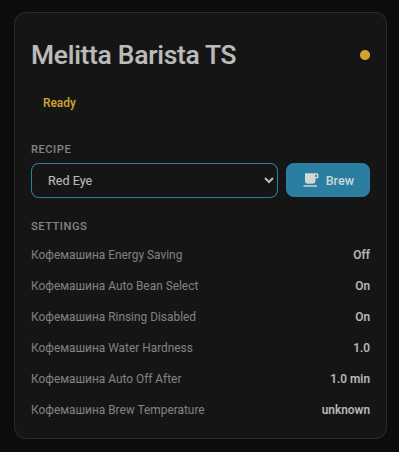

Sharing my custom integration for Melitta Barista T Smart / TS Smart coffee machines. It connects via BLE and lets you control the machine from HA — brew recipes, monitor status, change settings, run maintenance cycles.
This is an early MVP. I use it daily with my TS Smart and it works, but it’s far from polished. Expect rough edges and possible breaking changes. If you have a Melitta Barista — give it a try and let me know what breaks.
What’s there
  • BLE auto-discovery and pairing (D-Bus Agent1, no manual bluetoothctl)
  • Recipe select + brew button (21 recipes on T, 24 on TS)
  • Live status: state, activity, progress %, action required alerts
  • Settings: water hardness, brew temperature, auto-off, energy saving
  • Maintenance: easy clean, intensive clean, descaling, power off
  • Lovelace card with status, recipe picker, progress bar
  • 29 languages
Screenshot
Install via HACS (custom repository)
Integration: add https://github.com/dzerik/melitta-barista-ha → category Integration
Card: add https://github.com/dzerik/melitta-barista-card → category Dashboard
