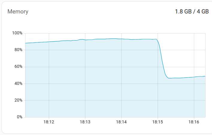

Till now (about 12 hours) still no crash, but… I think the memory causes the problem. Is this normal (up to 92,6%, than falling back to 46,6%) ?

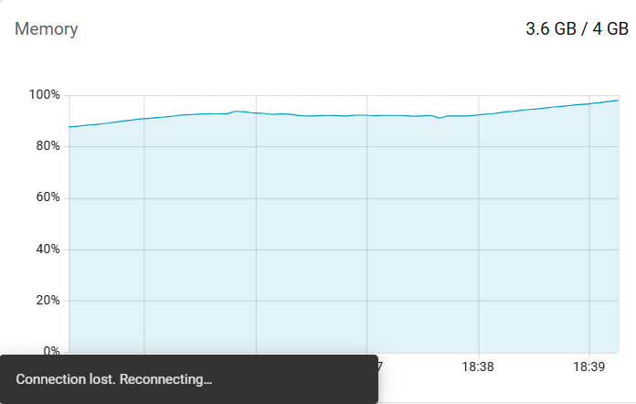

After enabling the Hikvision integration memory goes to 97,9%, this time not faling down :
And crash !
Solution ? New server ?
Code Server / VS Code App if you have that running will use over 1gb of memory. Turn that off if you are not actively using it or install more memory.
Aside from that, 2024.5+: Tracking down instability issues caused by integrations
