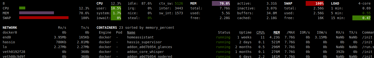

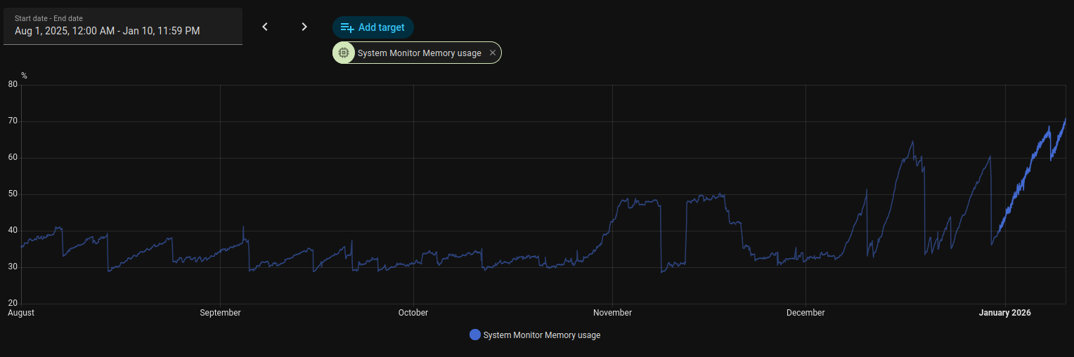

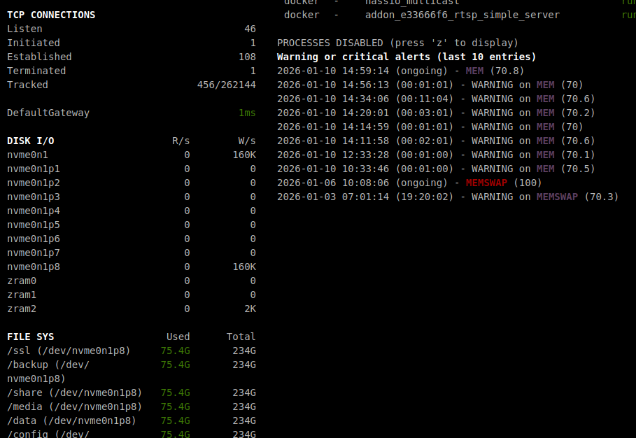

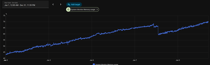

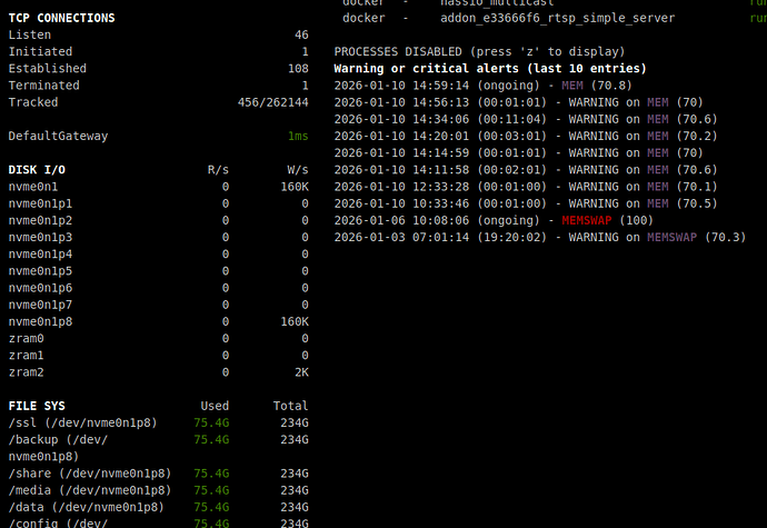

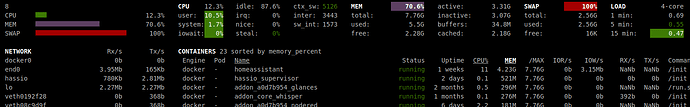

I believe have some type of memory leak issue. I’ve been running on a pi5 8GB with PCIe SSD for quite some time. As shown in the graphs, this only started occurring in October 2025. I’m not confident, but I think most/all of the reversions to baseline are due to restarts of the core and/or updates. I have attached the glances screenshot also which shows the OOM issue and that the HA core is the primary culprit, growing slowly but surely.

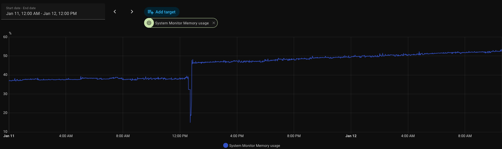

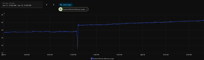

Thanks. Per the 2nd paragraph (which I added shortly after the post), I am on the latest version – seeing this issue since 2025.10.x. If you examine the graph timeline, the memory leak is extremely slow – 2-4% daily. Running in safe mode would break the functionality. Most of my automations are in node red, so I think that rules them out. Any other debugging suggestions?

updated to 2026.1.0. Trendline is the same.
