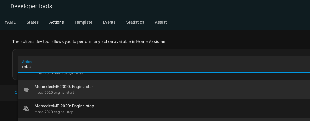

Could anyone give me some starting point on how to call “battery_max_soc_configure.”
I guess I am missing the idea how to call /start the service.
Hello, always ask - there are no stupid questions… (only lazy non-searching users :-))
“Service” was renamed to “Actions” in Home Assistant language some months/years ago. You could use actions everywhere in HA - in automations, buttons, voice and so on…
See here for some more details.
You can test the action via “Developer Tools”/“Actions” - select the Service/Action and an UI with the options gets rendered.
BR
Rene
thanks @renenulschde - got it
and is working for me (removed my VIN in Screenshot of course) ![]()
