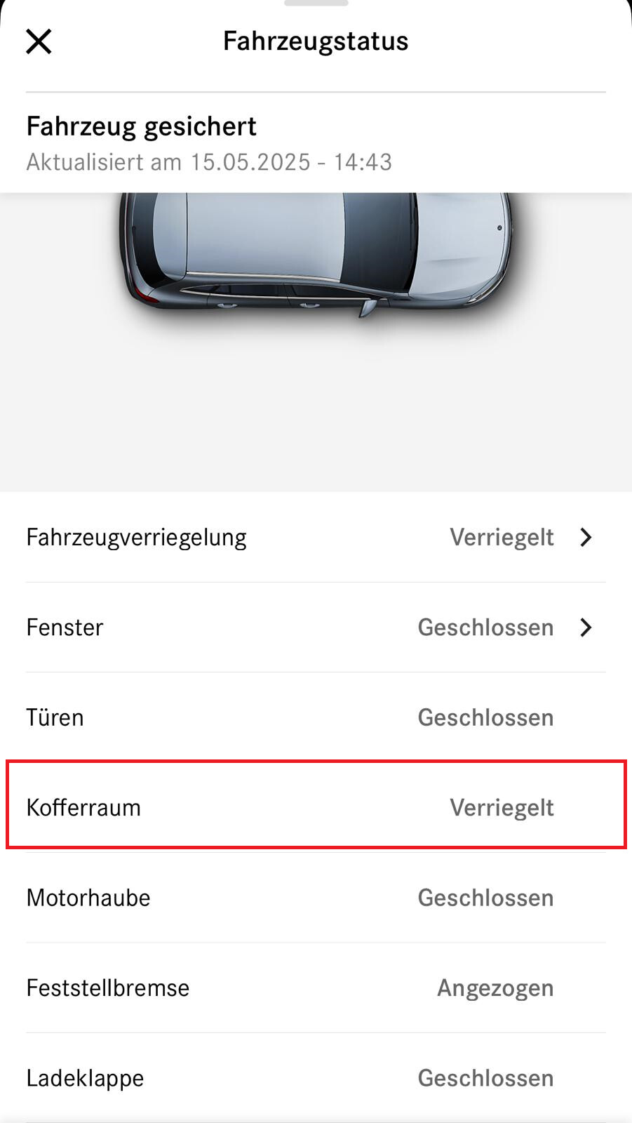

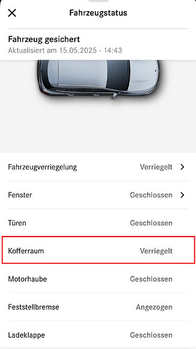

Is it maybe possible to add this/these sensor(s) to your integration:
Especially the “car boot” would be great. But the sensors of the doors (Türen) and bonnet (Motorhaube) would also be helpful.
Is this possible?
BTW: My car is a EQA 250 and I’m using the version 0.25.0 of your integration.
Thanks! Regards, Oilid

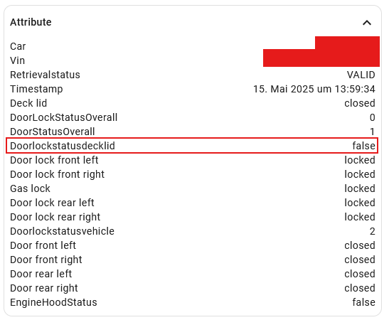

Did you look under the attributes of sensor.XXX_lock?
Especially the doorlockstatusdecklid?
Ah okay, you mean this one:
I thought it’s an own sensor and not an attribute of the lock-sensor. Thank for the info. I will check this…

@Thomas01 Unfortunately it doesn’t work. Nothing changes if i open the car boot. Also the doorlockstatusdecklid attribute doesn’t change into true. In the mercedes me app it works and shown as open… Is this a bug in the HA-integration?
Create a diagnostic report on the integration page when it’s closed. Open the decklid and create a new diagnostic report. Send the two files to [email protected] and I can analyze it.

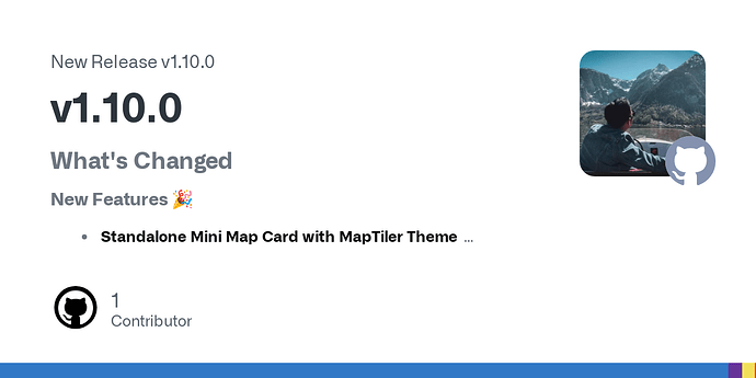

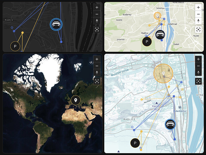

You can now enjoy a standalone mini map card with full MapTiler theme support, perfect for flexible dashboard layouts :call_me_hand:
Can I get some stars on the repo please? :star:
v1.10.0
What’s Changed
New Features :tada:
  • Standalone Mini Map Card with MapTiler Theme
    Added support for displaying the mini map as a full, standalone card on the dashboard. This new feature replicates the functionality of the native Home Assistant map card while incorporating the custom MapTiler-based styling for a consistent visual theme. Users can now integrate the map view more flexibly within their dashboard layouts. #152
Fixes :bug:
  • Fix theme application compatibility for HA 2025.5 #153
Full Changelog: v1.9.1…v1.10.0

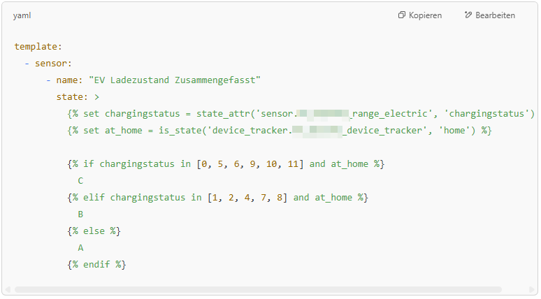

I will try to use this template sensor that ChatGPT just created for me:
You can test with developer tools editor if the template works.
It does work. What I meant is I will test it in a real life scenario, attaching/detaching the cable, charging the car etc. :slight_smile:
