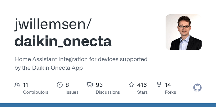

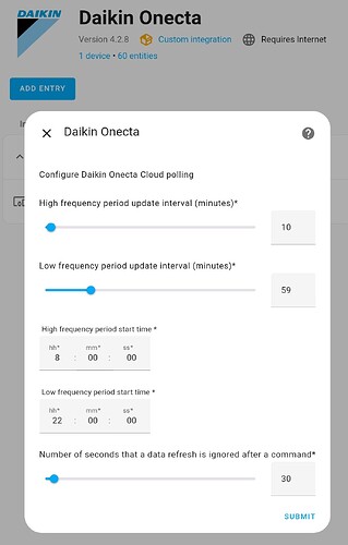

Just posting here maybe limit tthe number of connections or API requests like Daikin is doing, not sure if it will help…

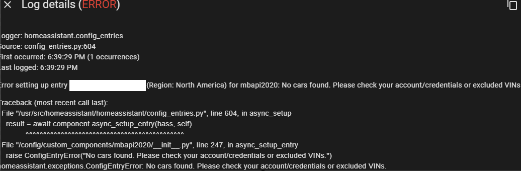

Started getting this error after updating

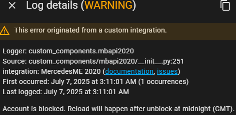

@alexr544 : This log entry is from Jul-7 and the latest release was on Jul-11th - so not related to the last update - but yes, some others are seeing this even with the latest update. Analysis ongoing…
Thanks. Thought i updated. Then did right after i posted this. Then started getting this. Did confirm my credentials are correct. As well as the VIN and code.
Its working for me now. Sorry for the trouble.
Was my own stupidity and i chalk it up to old person vision :slight_smile:
I put my VIN in the config thinking it needed it in the config. When all it did need was the pin and by me putting the VIN i excluded it.

This bugfixes should stabilize the overall flow. However, the blocking error will still appear and sometimes it will take after midnight until the websocket connection gets unblocked and the component gets reloaded…
