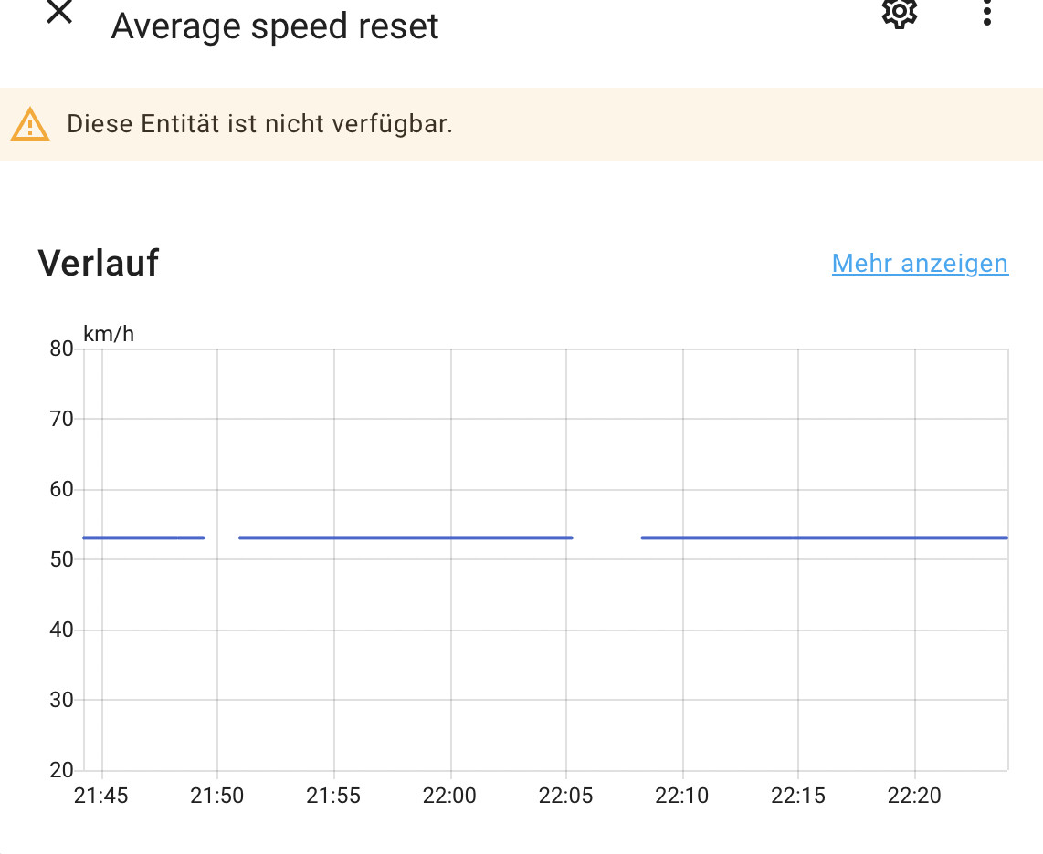

Hi Rene,
thanks for the great work :slight_smile:
I haven’t used the integration for a while, so I updated to v0.28 recently.
The recent car data seems to be avaialble (odometer, average speed is up to date), but all entities are not available somehow and I cannot use them:
Any idea what the reason could be?
Thanks
Markus
Hi Markus,
I propose that you enable the debug log (click on the three dots on the integration page upper right corner). Click then on reload the integration. Wait two minutes. Disable the debug and you will get a log file. Send me the log via email [email protected]
Or open a issue on GitHub and share all the requested data.

Please see the latest posts. In all the cases it helped to deactivate and reactivate the digital services in the official mb app.

I have answered your mail on 07-23. you need to enable the sensors again.
Hi Rene,
I was about to send you the logs, but surprisingly – everything is working now! Not sure what changed, but it seems to have resolved itself.
Thanks a lot anyway for your help!

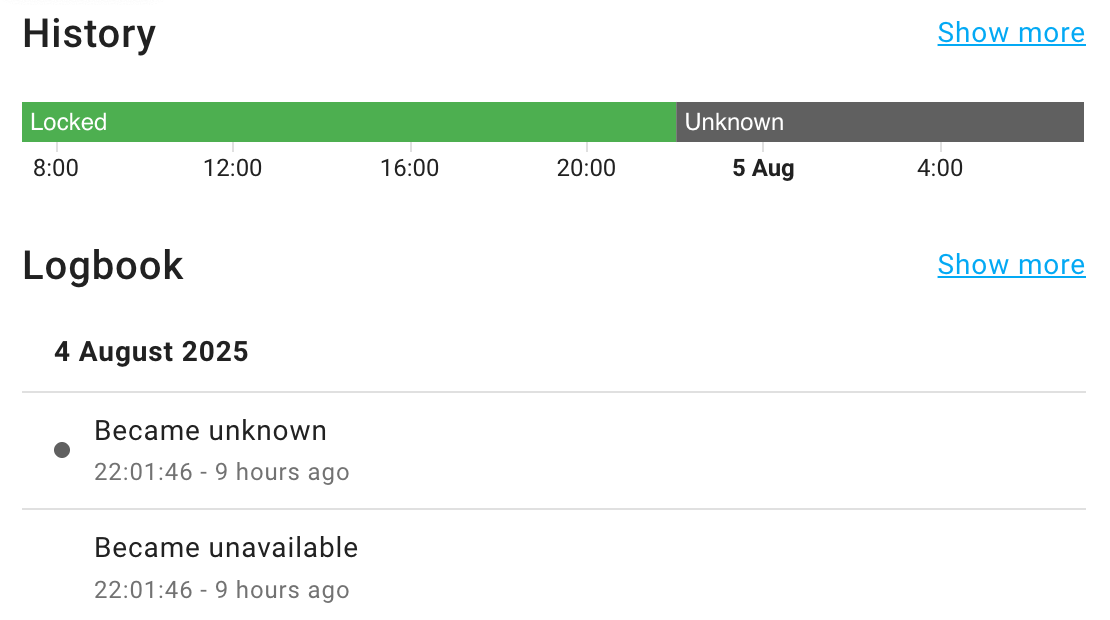

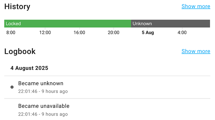

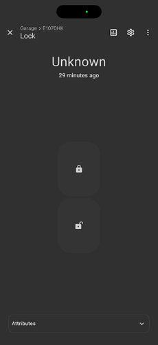

Hi Rene,
Since around 19:00 Bulgarian time today, my lock entity (lock.e1070hk_lock) started showing as Unknown in Home Assistant.
• Remote lock/unlock commands still work fine from HA and from the official Mercedes Me app.
• The problem is only with the status not updating in HA (always unknown).
• Tried full HA restart, reloading the integration, and complete reconfiguration (re‑auth), but the issue persists.
• I’m on version 0.29 of the integration, but also tested rolling back to 0.28 – same result.
• Other entities (fuel, odometer, etc.) still update normally.
Environment:
• Home Assistant Core: 2025.7.4
• Supervisor: 2025.07.3
• Operating System: 16.0
• Frontend: 20250702.3
• Integration: mercedesmeapi v0.29 (tested v0.28 too)
• Install method: HACS
• Vehicle: C220 Facelift W205 - 2018 year
Could there be a change in the Mercedes Me API affecting only lock status reporting? Or do you have any suggestions for debugging why the status would remain unknown while remote control still works?
Thanks for your great work on this integration!
Same here, but a bit later (22:01:46 CEST to be exact). I assume it’s an issue with the Mercedes backend.
Lock status sensor is functioning normally and accurately reporting its current state. At present, it is in the Locked state, and status updates are being successfully received in Home Assistant — in contrast to the remote control, which is currently experiencing issues.
Thanks for reporting - I see this issue in my environments too. Let me analyse it.
Solution:
I have published a bugfix release v0.29.1. See here for more details.
Analysis:
  • Since 2025-08-04 5am (GMT) the attribute “doorLockStatusOverall” is not reported by the API anymore.
  • This attribute is used to initialise the LOCK and show the current status
  • Whenever the attribute is not available the lock is not created.
Workaround:
Use the states of the lock sensor and use the HA-services/actions to execute lock/unlock actions…
