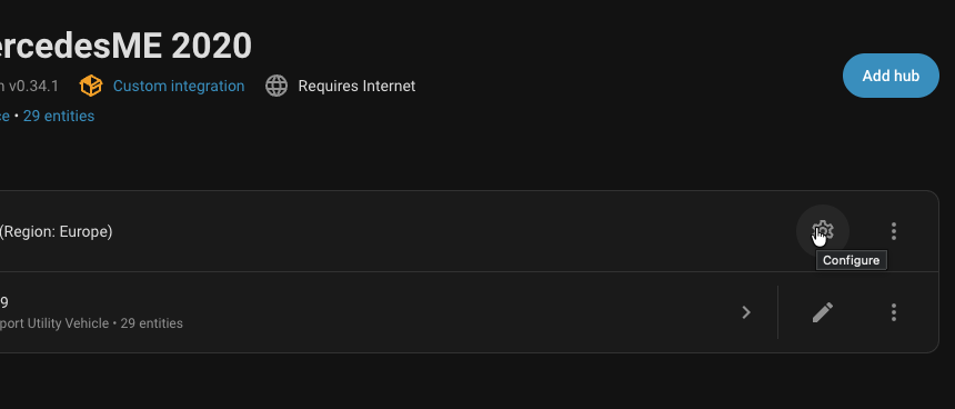

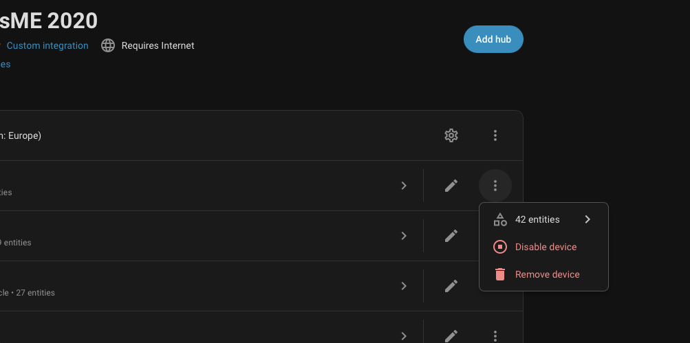

  • Remove car from hub: Added the option to remove a car device from the integration directly through the Home Assistant device page. This is intended for cleaning up old or decommissioned vehicles that are no longer linked to your Mercedes-Benz account. If an active vehicle is removed, it will be automatically re-added on the next reload or restart of Home Assistant. (Fixes: #388)

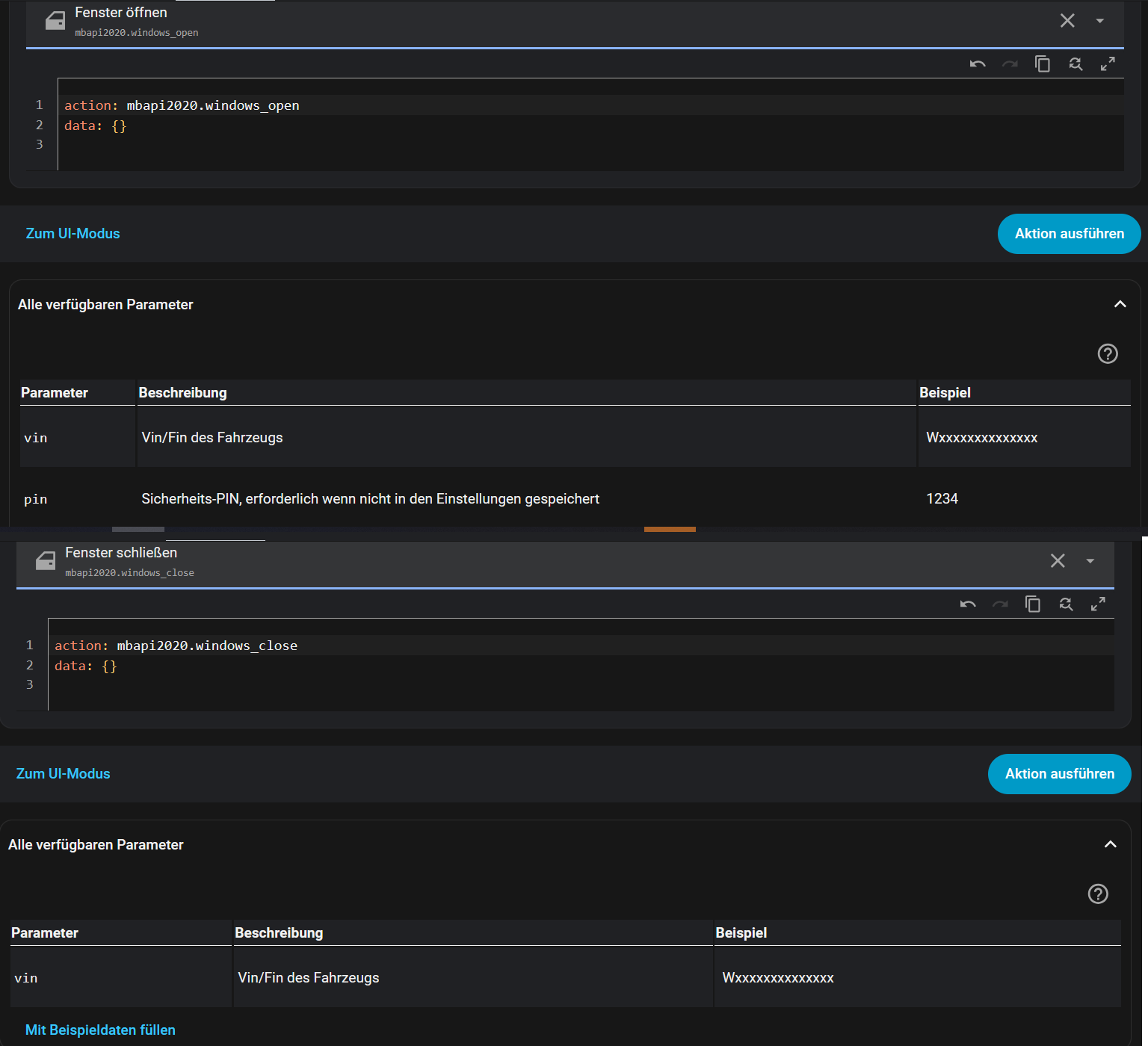

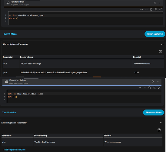

I got an A Class 2024 (latest Version) and I wonder why there is no PIN option for closing the windows? Because I can’t close my windows without the PIN. I only can open the windows, because there is an PIN option
I think for the windows_move option I also need a PIN Code
Windows close should work without a PIN.

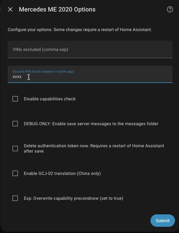

Windows move requires a PIN. This is a bug in the frontend. (Update: Fixed. will be part of the next release.)
Workaround:
You can setup the PIN in the options dialog of the config entry - the PIN will be used in all calls:
Thank you! That works for me now.
I don’t know, but my car doesn’t close the windows without a PIN.Also in your describtion “Sicherheits-PIN, erforderlich wenn nicht in den Einstellungen gespeichert”…So i was thinking this option is required.
But your workaround is much better, so I don’t have put the PIN in all my scripts/automations.
I think my car doesn’t support windows move. I can only open/close all the windows.
