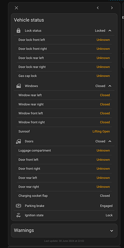

So, I’ve currently tested with Version v0.37.0-beta.2. With custom cards, I only encountered a problem with the previously mentioned change, where attribute values are converted from string/boolean to int. If in the offic release will includes only these changes, it won’t be a problem to update the card, to make it compatible.
It appears that the changes so far only affect attributes, not entity state? see below. For the lock sensor the raw state, it’s still the string “2" so, in the card it render correct translated value.
sensor.*_lock
state:
  translated: Locked
  raw: "2"
  last_changed: "2026-06-30T20:02:14.975Z"
  last_updated: "2026-06-30T20:02:14.975Z"
attributes:
  retrievalstatus: VALID
  timestamp: "2026-06-30T17:05:16"
  decklidstatus: 0
  doorStatusOverall: 1
  doorlockstatusdecklid: 0
  doorlockstatusfrontleft: 0
  doorlockstatusfrontright: 0
  doorlockstatusgas: 1
  doorlockstatusrearleft: 0
  doorlockstatusrearright: 0
  doorlockstatusvehicle: 2
  doorstatusfrontleft: 0
  doorstatusfrontright: 0
  doorstatusrearleft: 0
  doorstatusrearright: 0
  icon: mdi:car-key

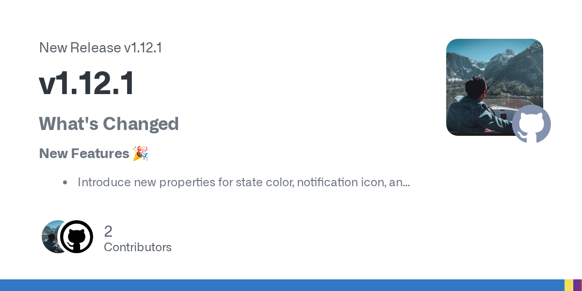

Vehicle Info Card v1.12.1
What’s Changed
Compatibility Update for the New Version of Integration.
New Features :tada:
Fixes :bug:
Other Changes
Full Changelog: Comparing v1.11.0...v1.12.1 · ngocjohn/vehicle-info-card · GitHub

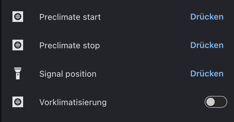

Hi, I recently got a new car and integrated it with Home Assistant. I’m wondering why there are both buttons and a switch for “Preclimate.” Is there a reason for this?

There’s no reason other than that the component has been around for a few years now, and certain features were added to Home Assistant over time → First there were services (today: actions), later switches, and then buttons… If you search through this thread, you’ll surely find the reason why the buttons or switches were added — I can’t remember anymore…
