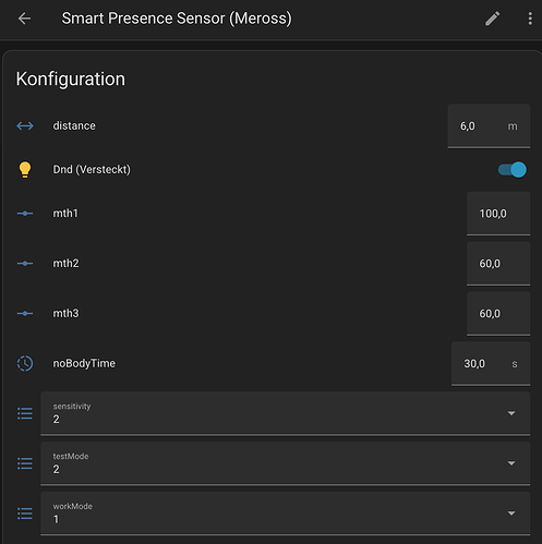

For me its working ok-ish. I wonder what the configuration entities are:
I guess “distance” is the detection distance. i am actually almost 6m away from the sensor and this works. Maximum seems to be 12m:
DnD might be the on-device LED and
  • nobodyTime
  • sensitivity
    seem self-explanatory. Any ideas about the rest?
