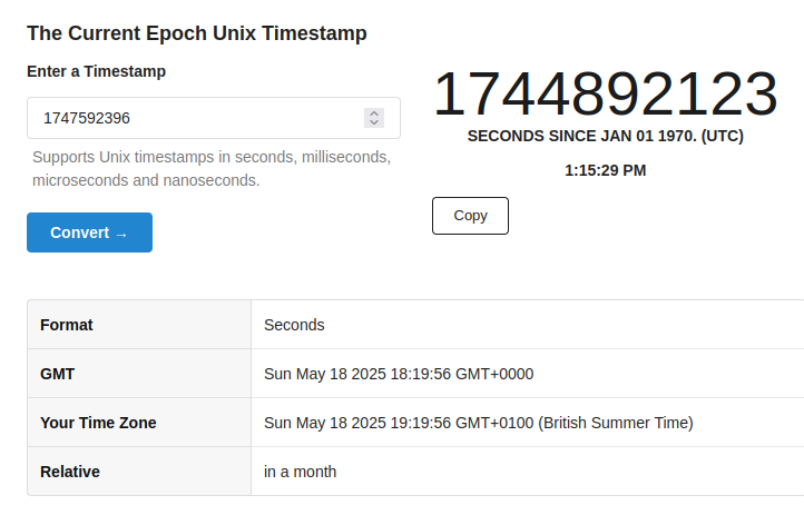

Might be coincidence, but the first ten digits of that number represents a UNIX time stamp for just over one month from now.
wow, that’s a special kind of brain you have :smile:
