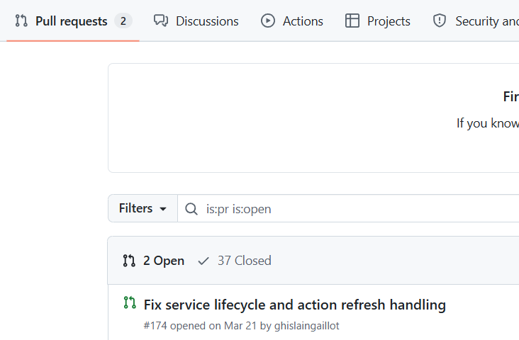

hiyah - i need some help to understand what to do. Can you provide any guidance. I'm a GIT noob. I found the #174. Now what do I do?
@Angus_M , sure. So in theory, all you should need to do is:
  1. In HA, remove the MG integration from Services and Settings.
  2. Go to HACS
  3. Find MG in the list and remove the integration
  4. Then, click the 3 dots at top right
  5. Choose Custom Repositories
  6. Paste the following into the box: GitHub - ghislaingaillot/mg-saic-ha at fix/service-lifecycle-refreshes · GitHub
  7. Select the type as Integration
  8. Search for MG SAIC.
  9. You will probably see 2 options for the integration
  10. Install the option from the alternative repository (the one that says 2months ago under Activity column)
  11. Reboot HA
  12. Try and add the integration

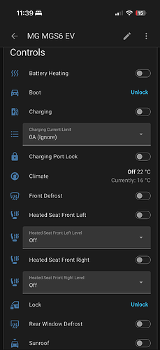

@Angus_M well I got my new car today (MGS6):
I have everything working in HA using the PR version of the code (I am waiting to take over the GitHub still and this gives me time to test out the PR).
Like I said before, log out of your iSmart account, create a new account with a different email address, approve the email that MG send you, sign back in to iSmart with your main account, add a secondary account using the previous step email (remembering to set no expiry date).
Then install the PR HACS update, reboot HA, add the integration and use your new secondary account email address and password:
