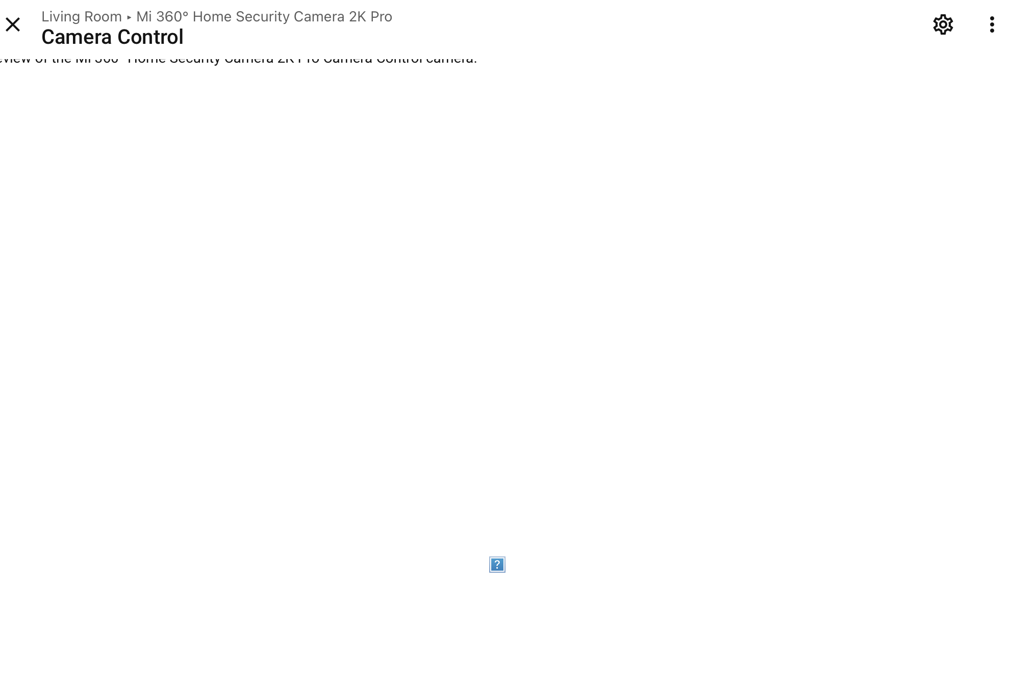

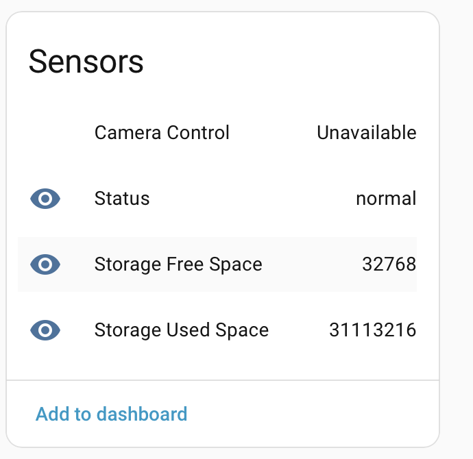

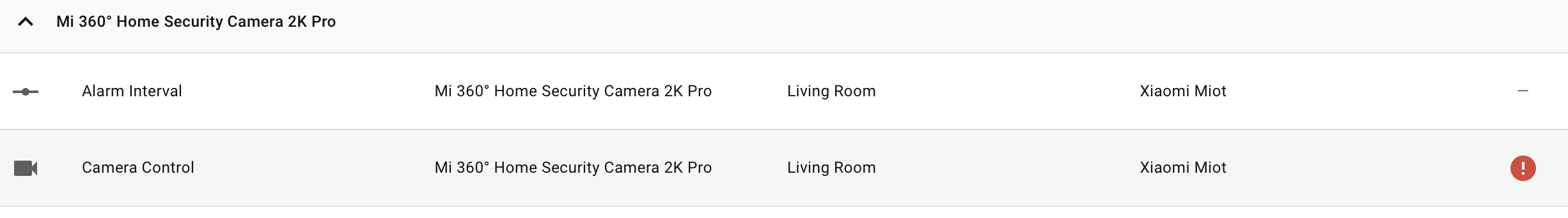

I was managed to install xiaomi miot (GitHub - al-one/hass-xiaomi-miot: Automatic integrate all Xiaomi devices to HomeAssistant via miot-spec, support Wi-Fi, BLE, ZigBee devices. 小米米家智能家居设备接入Hass集成 · GitHub) via method 4. It recognised the camera and all buttons as controls works well. However the Camera Control in the sensor area is unavailable. No streams / pictures.
Does anyone knows what I am missing still ?
