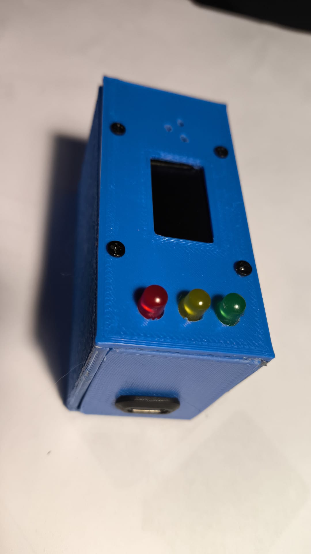

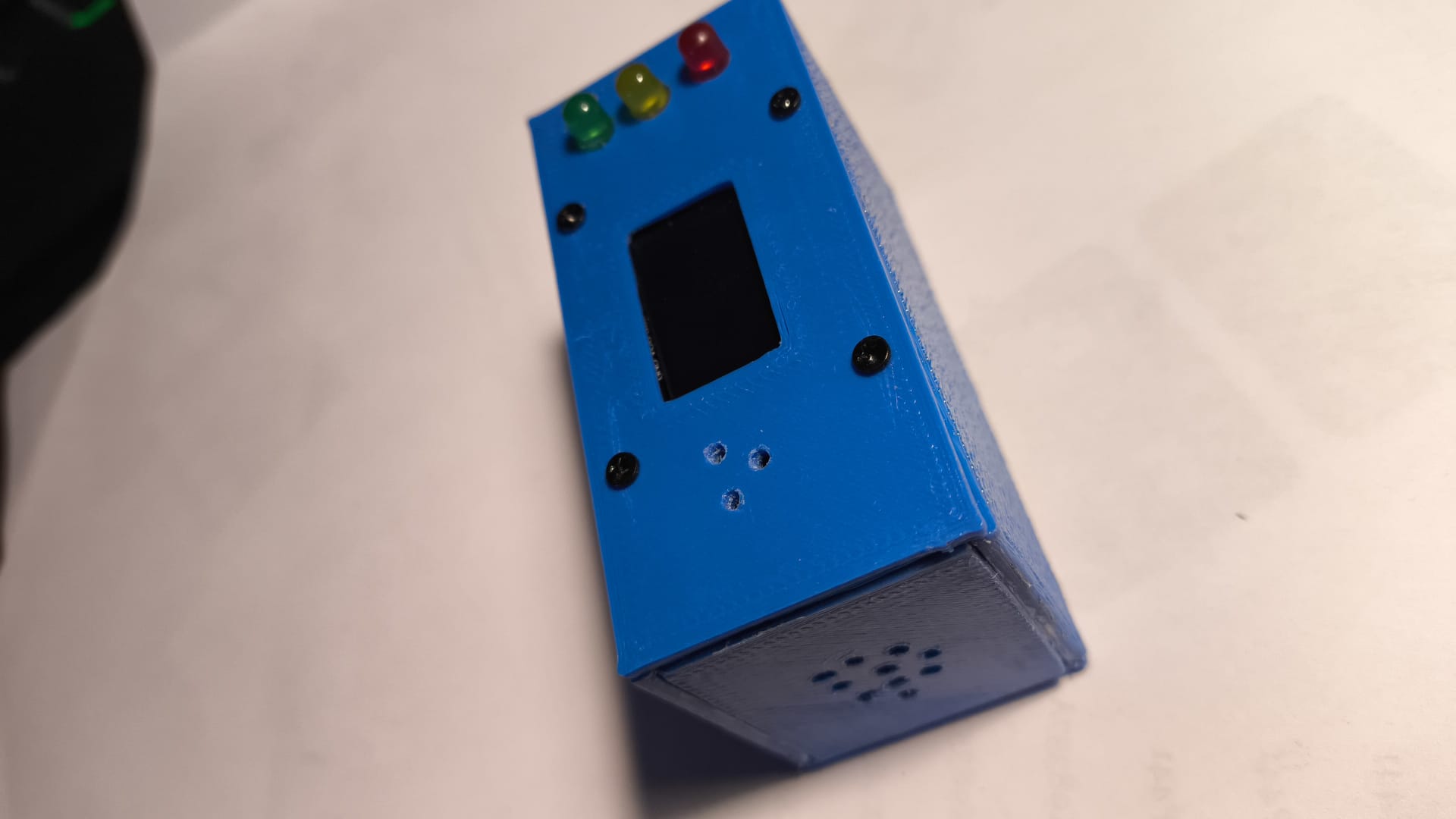

Hola a todos, es mi primer comentario :smiley:
Partiendo de una esp32 s3 + inm441 + max98357A + ld2410c y una pantalla de 0.98" he fabricado un satelite de voz con sensor de presencia, microfono, altavoz y pantalla. Tengo la opcion de mutear el micro completamente o regular su volumen. El sensor de presencia funciona por presencia completa o por cercania. La pantalla me indica ssid al que esta conectado, la ip y la intensidad de seƱal wifi,y funciona con activacion de palabra clave ā€œok nabuā€.
Tiene tambien 3 leds, uno de eschucha, otro de presencia y otro cuando nabu responde.
Le hice una caja provisional, aunque tampoco queda mal.
adjunto algunas fotos.
Siento si no es la seccion correcta para poner esto.
Hi everyone, this is my first post :smiley:
Starting with an ESP32 S3 + INM441 + MAX98357A + LD2410C and a 0.98" screen, I’ve built a voice satellite with a presence sensor, microphone, speaker, and screen. I have the option to mute the microphone completely or adjust its volume. The presence sensor works by full presence or proximity. The screen shows me the SSID it’s connected to, the IP address, and the Wi-Fi signal strength, and it works with the keyword ā€œOK Nabuā€. It also has 3 LEDs: one for listening, one for presence, and one when Nabu responds.
I made a temporary enclosure for it, although it doesn’t look bad.
I’ve attached some photos.
I’m sorry if this isn’t the right section to put this.
1Āŗ photo
2Āŗ photo
la proxima version sera con caja de 1 pieza en resina o mecanizado cnc, esta es en filamento pla.
The next version will have a one-piece resin or CNC machined case; this one is made of PLA filament.
Very nice!
If you post your code that could be helpful for anybody trying to accomplish the same.
