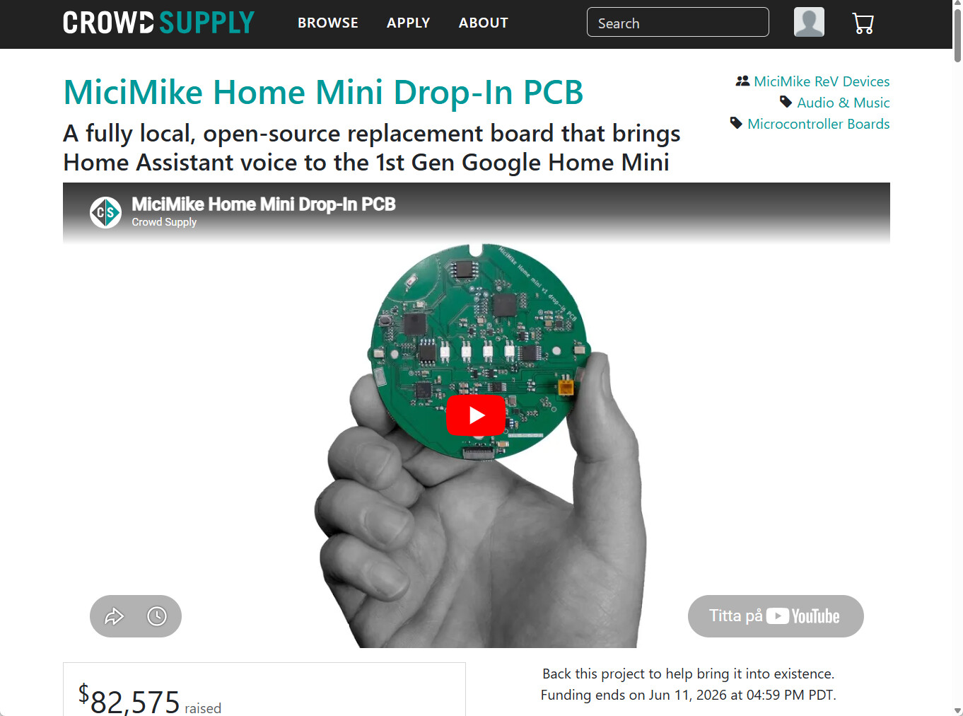

Hi everyone,
I wanted to share a project I’ve been working on for a while — a drop-in replacement mainboard for the Google Home Mini (1st gen) that turns it into a fully local Home Assistant voice assistant.
The idea is simple: the original Google Home Mini has a decent speaker and a compact, well-designed enclosure — all perfectly usable. The only thing holding it back is the proprietary mainboard. This project replaces just that.
What’s inside the replacement board:
  • ESP32-S3 — handles ESPHome, Wi-Fi, and HA integration
  • XMOS XU316 — dedicated audio DSP for mic processing (noise suppression, echo cancellation)
  • Fits directly into the original enclosure, reusing the case, speaker, power daughterboard, and touch surface
  • Firmware comes pre-flashed; configure it like any other ESPHome device
No cloud. No Google account. No subscription. Just a local voice assistant that runs entirely within your Home Assistant instance.

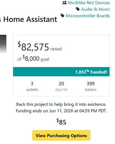

@iMike78 Congratulations in advance on the success of your crowdfunding campaign so far!
Spotted funding is currently 1032% funded with 399 backers and 593 PCB boards claimed!
