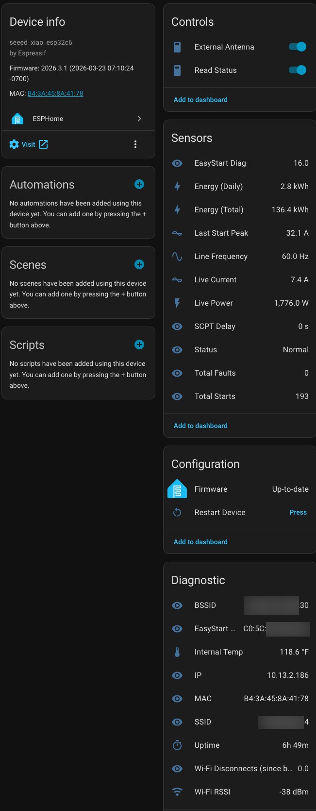

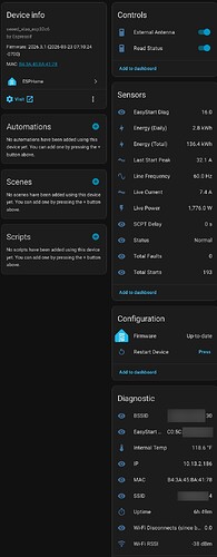

Very recently I purchased the Micro-Air EasyStart Flex and via ESPHome, got it connected to Home Assistant. What is the Micro-Air EasyStart Flex? It is an advanced and versatile soft starter, designed for all sizes of residential A/C units up to 6 tons (72,000 BTUs).
You can check out my full blog post here: ESPHome: Micro-Air EasyStart Integration

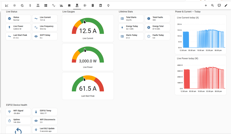

Hey just wanted to let you know I am using your integration, it works great, the identification of the MAC BLE, etc.. nicely done!
Awesome! Glad it worked.
Just want to said thank for this.. This integration is working perfect..
Awesome, glad it worked for you!
